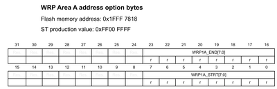

I am trying lock a portion of Flash memory using WRP(Write Protection). when I am configuring the Option bytes for WRP. I am using STM32L443VC MCU and I have multiple questions:
1. Which area to select WRPAreaA or WRPAreaB for page 0 to page 11 because there is no division of area given?
2. I am trying to lock from page 0 to page 11 in the flash memory but I am seeing different values even after OBL launch:
example: WRPStartOffset = 0x80  (Expected: 0x00)
                WRPEndoffset = 0x0B (Expected: 0x0B)
This is because in the reference manual I see FLASH_WRP1AR reset value is 0xFFXX FFXX and in the register value is 0xFF00 FFFF. If I use Register value got 0xFF0B FF80 instead of 0xFF0B FF00. if I assume 0xFF00 FF00 i am getting 0xFF0BFF00. Even I tried for different page offset still I am seeing Startoffset value different. Please check the attached snapshots for your reference.

Here is the detailed Observation:
In FLASH_OB_WRPConfig function, there is a modify_reg operation
#define MODIFY_REG(REG, CLEARMASK, SETMASK)  WRITE_REG((REG), (((READ_REG(REG)) & (~(CLEARMASK))) | (SETMASK)))
if(WRPArea == OB_WRPAREA_BANK1_AREAA)
      MODIFY_REG(FLASH->WRP1AR, (FLASH_WRP1AR_WRP1A_STRT | FLASH_WRP1AR_WRP1A_END),
                 (WRPStartOffset | (WRDPEndOffset << 16)));
CLEARMASK = FLASH_WRP1AR_WRP1A_STRT | FLASH_WRP1AR_WRP1A_END =
0x0000007F | 0x007F0000 = 0x007F007F.
SETMASK = (WRPStartOffset | (WRDPEndOffset << 16)) = (0x00 | (0x0B) << 16)) = 0x000B0000
~CLEARMASK = ~(0x007F007F) = 0xFF80 FF80
(READ_REG(REG)) & (~CLEARMASK) = (0xFF00FFFF) & (0xFF80 FF80) = FF00 FF80
(READ_REG(REG)) & (~CLEARMASK) | (SETMASK) = (FF00 FF80) | (0x000B0000) = 0xFF0B FF80.
Expected is 0xFF0B FF00, Observed is 0xFF0B FF80.
READ_REG(REG) value is 0xFF00 FFFF. I saw the same value in registers and in STM32CubeProgrammer.
In reference manual. reset value is 0xFFXX FFXX.
The value setting is not as per expected value. Even I can see the values in the STM32CubeProgrammer as observed value(0xFF0B FF80) after flashing the code.

In the Reference Manual, these fields are 8 bits in width
In the CMSIS files, these fields are only 7 bits in width.
cmsis-device-l4/Include/stm32l443xx.h at a2530753e86dd326a75467d28feb92e2ba7d0df2 · STMicroelectronics/cmsis-device-l4
Because the default value for WRP1A_START is 0xFF, when the program tries to change it to 0x00, it doesn't modify the 8th bit, so it gets set to 0x80 instead.
The CMSIS file for various STM32L4 chips seem to set the width of this field based on how much flash memory is available, but that doesn't seem to be correct per the RM.

Thank you for highlighting such behavior to us, as well pointed by @TDK can you update manually at your local file that CMSIS file by:
/****************** Bits definition for FLASH_WRP1AR register ***************/
#define FLASH_WRP1AR_WRP1A_STRT_Pos (0U)
#define FLASH_WRP1AR_WRP1A_STRT_Msk (0xFFUL << FLASH_WRP1AR_WRP1A_STRT_Pos) /*!< 0x000000FF */
#define FLASH_WRP1AR_WRP1A_STRT FLASH_WRP1AR_WRP1A_STRT_Msk
#define FLASH_WRP1AR_WRP1A_END_Pos (16U)
#define FLASH_WRP1AR_WRP1A_END_Msk (0xFFUL << FLASH_WRP1AR_WRP1A_END_Pos) /*!< 0x00FF0000 */#define FLASH_WRP1AR_WRP1A_END FLASH_WRP1AR_WRP1A_END_Msk
and let us know if the behavior is fixed ?
In our Reference Manual we are using the 8-bits for decoding logic, and I believe it is correct on How the start and end pages works.     Here is an internal Ticket Number for Follow-up in future #214744

I have updated the change in local file and the issue is fixed. WRP is enabled and verified in STM32CubeProgrammer.
