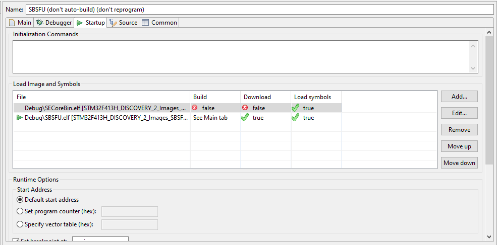

Thanks for your response and confirming I can debug in the callgate. I've set up the debug configuration as suggested (including setting the symbol address of the SECoreBin to 0x00) and stepped into SE calls in instruction stepping mode, but still no luck. Are there settings within project properties for the SBSFU and/or SE projects that I may be missing?0693W00000WIGg2QAH.pngBest,

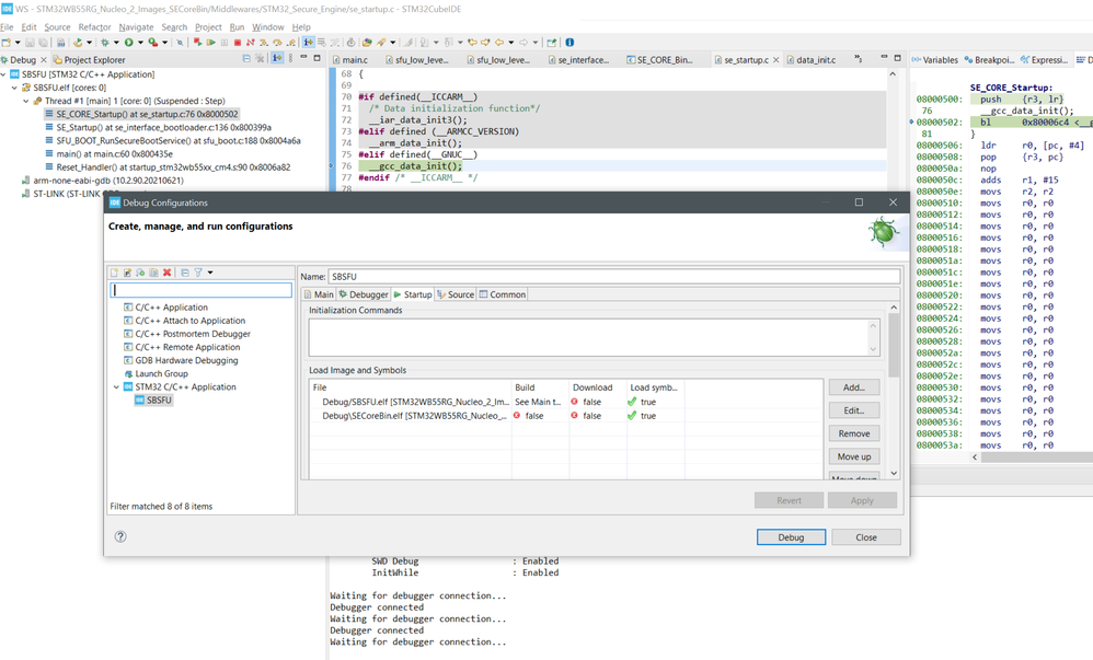

I made a quick test and with your configuration I confirm it does not work.
To make it work, untick the download of SBSFU and also move the SBSFU line up like this.
0693W00000WIGyBQAX.pngI hope this will work better on your side !

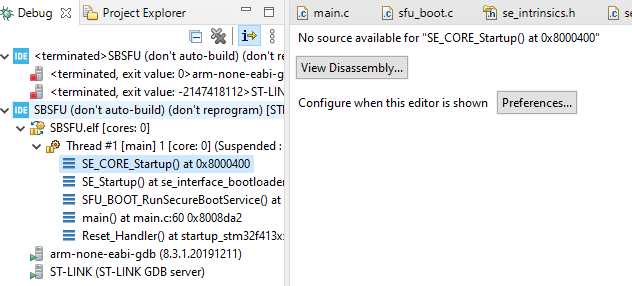

I have tried unticking the download of both the SBSFU and SE, but still no success. I can debug the code though the SE_SVC_Handler() but once I step into SE_CallGate() I get "no source available". When I try stepping into SE_CORE_Startup() like in your screenshot, I get the same issue. I made sure that the SECoreBin project is also in the source lookup path in the debugging configuration.

did you move SBSFU line on top in the debug/startup ?
Also, one thing I didn't set "Use symbol address".
Maybe one or other point may help

Finally got it! I had moved the SBSFU to the top line, and then had the symbol box checked, but did not set a value. I am now able to debug in the callgate.
For someone's potential future reference, I am in IDE v1.7.0
