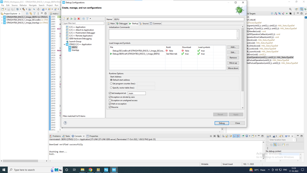

I tried to execute my custom SBSFU_UserApp.bin on the STM32H7B3I-DK board and I get error for Header signature verification failure in slot SLOT_ACTIVE_1.
I have made changes in se_crypto_bootloader.c file for adding RSA signing verification in place of ECDSA.
I want to debug the changes inside of se_crypto_bootloader.c file of SECoreBin project.
I am using STM32Cube IDE and compiling the applications as per the order mention in the readme file of the STM32H7B3I-DK 1_Image demo project.
Please let me know, what is the debug mechanism for SECoreBin application? How can I enable debug mode of SBSFU Secure Engine application?

‎2022-10-12 11:44 PM
Hi @Ikbal​ ,
SECoreBin does not allow any logging mechanism like PRINTF as this woud increase the attack surface.
Therefore, to debug, you need to go directly with the debugger.
To do so, you need to make sure you did not activate the protections preventing debugger access (like DAP deactivation).
Once this is done, to debug in SECoreBin, you need to be able to move from a first binary (SBSFU) into another binary (SECoreBin).
So, you must load the symbols of this second binary.
If you want to follow the execution flow with the debugger you need to provide the appropriate elf file when needed (in the debug console)
For instance to load the SE_CoreBin symbols in the gdb console:

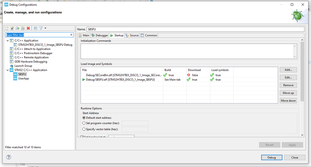

I tried to debug the application as per your suggestions and I am able to debug the application. Here I am attaching the SBSFU and SECoreBin debug configuration in STM32Cube IDE.
Now I want to check my custom application. I have made changes in the se_crypto_bootloader.c to add RSA sign verification. I have also change the length of sign in the se_def_metada.h structure.
When I enable the debug and run the application the SBSFU application work fine and asking for loading sfb using YMODEM. I followed the steps and load the UserApp.sfb file but I am getting an error called Fw header authentication error. I have attached the complete tera term log.

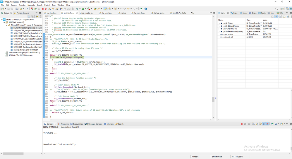

I have tried to debug the error and find that my application is returning SFU_ERROR from SE_ErrorStatus SE_VerifyHeaderSignature(SE_StatusTypeDef *peSE_Status, SE_FwRawHeaderTypeDef *pxFwRawHeader) function of se_interface_bootloader.c file.
After uploading the UserApp.sfb file the debugger stop at the same function and execute the if part and return SFU_ERROR from there. Please correct me if I am doing something incorrect. I am attaching the photo of this section.
I am unable to understand the reason for this error. Please help to fixed this error.

‎2022-10-14 1:28 AM
Hello @Ikbal​,
On top of Fred's answer, I could add that you can add this elf file directly in the debugger configuration in the startup tab.
Click Add ... buttong, select elf file, deselect Perform build and deselect download.
Leave Load symbols and use address 0.
You should get things working.
Also, as Fred said, you should disable security protections. You can leave MPU enabled: this allows debugging MPU configuration related issues :)

As mentioned in previous posts, I am not able to debug the SECoreBin application in which I have made many changes. I need your support to enable me to debug the SECoreBin application.
The debug configuration is detailed below where I tried to enable debugging of SBSFU and SECoreBin application:
Thereafter, I tried to debug the SECoreBin application by in inserting a breakpoint in SE_ErrorStatus SE_CRYPTO_Authenticate_Metadata(SE_FwRawHeaderTypeDef *pxSE_Metadata) function of se_crypto_bootloader.c. I am getting errors detailed below when I load the UserApp.sfb file and resume the debugging.
Please let me know:
1) If the configuration is correct
2) If the approach for debugging through breakpoints which are inside SECoreBin as above is correct
3) Any other aspect which I may have missed when debugging SECoreBin

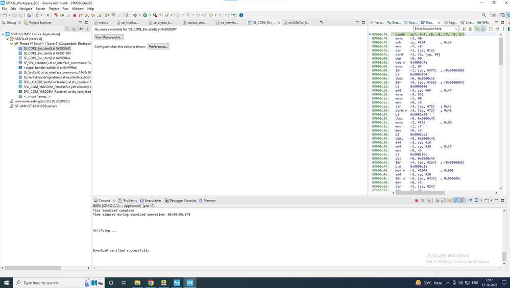

‎2022-10-17 3:59 AM
Hello @Ikbal​,
Apparently, you are not able to debug properly.
This needs to be fixed first.
As I said:
you need to configure debugger with
Click Add button, select elf file, deselect Perform build and deselect download.
Then when reaching the last call to SE, you will need to step into in assembly mode.
Debugger is not able to step into in C mode.
All code in SE should be displayed
Best regards
Jocelyn
‎2022-11-11 8:59 AM
Similarly, I am trying to debug the SECoreBin but am unable to step through it even after setting the 'Startup' tab similarly in the debug configuration. Stepping through in instruction mode does not help the issue. Are there any other configurations that need to be made to get this to work?
‎2022-11-11 9:37 AM
Specifically, I'm trying to debug within the callgate, is this even possible?
