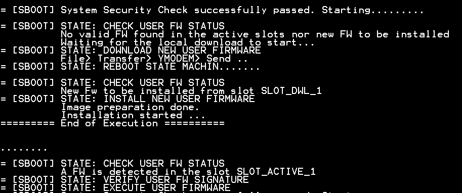

Hi, I am a beginner in SBSFU.
STM32L4S7ZIT6
STM32CUBEIDE Version: 1.12.0
STM32CUBEProgrammer v 2.13.0 (for download SBSFU and full chip erase)
Tera Term v 4.106

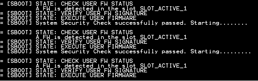

When run SBSFU, I can get EXECUTE USER FIRMWARE at end, but cannot run UserAPP.
if reset SBSFU, still cannot run UserAPP.

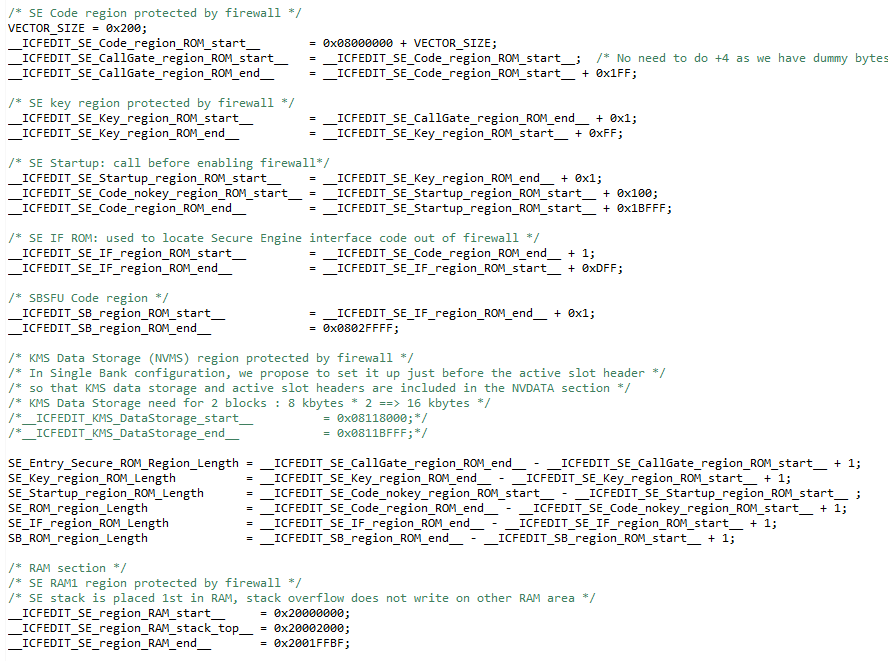

3. modify linker_common and STM32L4S7ZITX_FLASH.ld by STM32CubeExpansion_SBSFU_V2.6.2 (B-L4S5I-IOT01A)
4. modify system_stm32l4xx.c and STM32L4S7ZITX_FLASH.ld in UserAPP for SBSFU( if don't change, i mean that UserAPP can run normally without SBSFU)

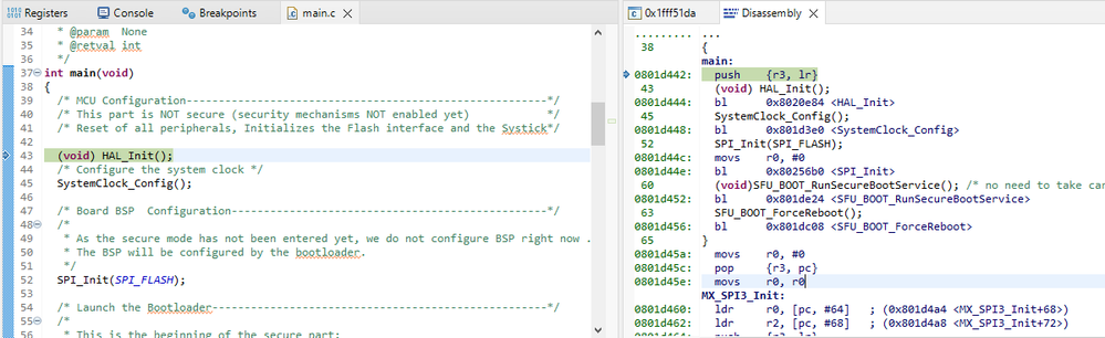

1. if i run UserAPP alone, it show error Break at address "0x1fff51da" with no debug information available, or outside of program code. then it can run to main.
2. if i run SBSFU alone, it show error Break at address "0x1fff51da" with no debug information available, or outside of program code. then it can run to main. (i think the correct one is i can see run at startup_stm32l4s7.s then back to main)
i don't know why after SBSFU the UserAPP cannot run. Maybe the point is 0x1fff51da?

The good news is I follow you suggestion, and find the solution. I make some mistakes on SLOT_Active_1 address . Also i change the memory area for ISR_VECTOR. Both is in the STM32L4S7ZITX_FLASH.ld.
now it is working as expected.
