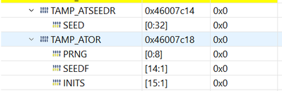

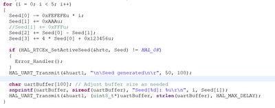

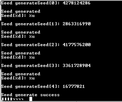

Hi all,
I'm trying to implement Active Tamper in STM32U585 controller, im trying to generate the SEED, the Seed is getting generated, but the SEED is not getting updated in the SEED reg of tamper, i'm attaching the code and seed values generated for reference. can anyone help me whats wrong here,
reference image for Seed reg not updated.

Once programming the SEED value with four write access, you should wait until SEEDF = 0 in TAMP_ATOR.
if the function HAL_RTCEx_SetActiveSeed() return HAL_OK, it means that the SEED programming is OK.
To use the HAL_RTCEx_SetActiveSeed() function,  the Active tamper need to be already enabled with HAL_RTCEx_SetActiveTampers().

TAMP_ATSEEDR register is write only, you cannot read back the programmed value.
Best Regards,
Ced
Hello @Ced
Thanks for the reply, yes SEED is only write, but the (TAMP_ATOR) is read, once the SEED is generated this should be high, its as per my understanding, correct me if im wrong here.
