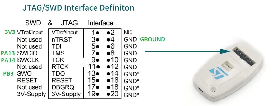

Hello... I'm learning to use an external ST-Link to debug the F446ZE Nucleo using SDW. Can anyone advise on how to connect the SDIO, SDW pin on the Nucleo board to the external ST-Link v2? Additionally, what settings should I configure in CubeIDE to use the ST-Link v2? I also have an ST-Link v3. Any advice on ST-Link v3 is also welcome, thank you.

SWDIO and SWCLK  you mean? SWD ? What's SDW, dyslexia?
You'd need to connect directly to the respective PA13/PA14, most readily via the CN4 jumpers you'll remove to disconnect the local ST-LINK from the STM32 Target.
You'll need to look at the schematic and probe the pins to understand which side connects to what.
You'd need to power the ST-LINK/V2 buffers via a connection to Pin 1 VTarget on the 20-pin header.
PB3 (SWO) and NRST are connected more directly, so might be solder bridges or traces to be cut to adequately separate the them from the on-board ST-LINK
For CubeIDE you'll need to select the debug pod you plan on using.

hello.. can anyone help to decipher the SWD connector CN6 pinout? i need to know CN6 pin 1 to 6 connect to what pin eg, which PIN is SWCLK, which is SWDIO, RST ... i m using external ST-Link v2 to connect to CN6. Please advise, thx

CN6 Exports an SWD connection, it's NOT for connecting an external ST-LINK to the LOCAL TARGET
SN6.1 VCC being measured
SN6.2 SWCLK
SN6.3 GND
SN6.4 SWDIO
SN6.5 NRESET
SN6.6 SWO (PB4) Serial Wire Viewer
If you want to connect an External ST-LINK CN4 will be better
Remove the JUMPERS to disconnect on-board ST-LINK
CN4.2 TCK/SWCLK LOCAL TARGET Connect External ST-LINK SWCLK
CN4.4 TMS/SWDIO LOCAL TARGET Connect External ST-LINK SWDIO
Use CN6.3 to establish a common ground

What about CN4.1?  Do you need to connect the CN4.1 (3v3) to the ext. STLink v2 ?  (show below)
