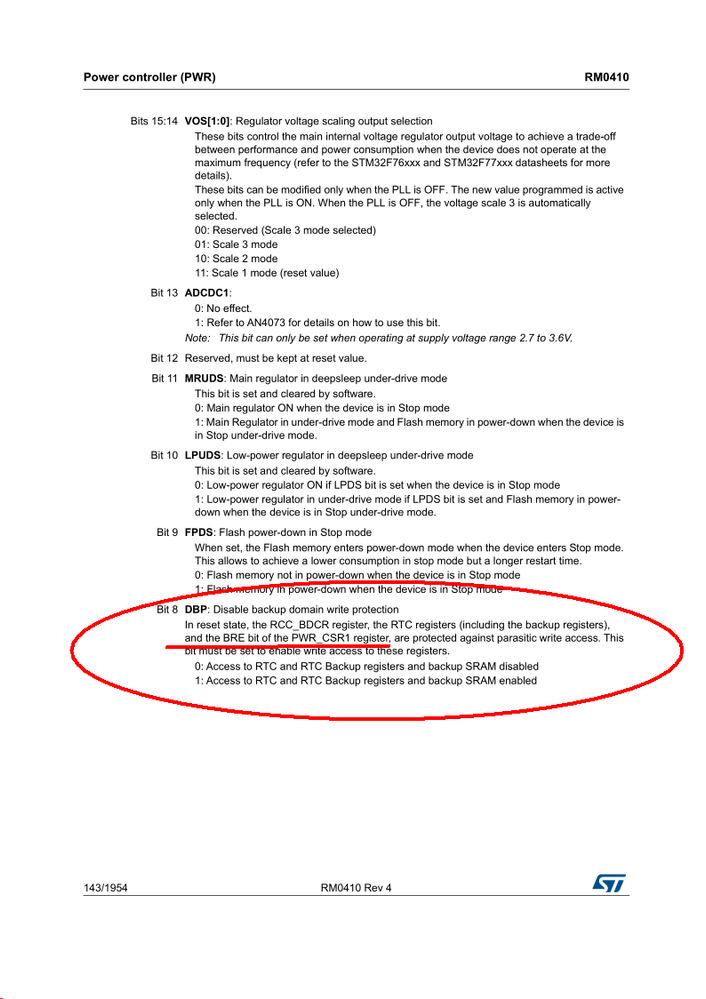

Writing to STM32F767 battery backed SRAM, why can't I turn on PWR->CSR1 BRE
I need to write to the 4kB battery backed SRAM to hold information across power cycles, but it's not working! To be more specific:
  1. The debugger memory display shows the correct data in SRAM after a write.
  2. The data is read successfully at any time other than after a power cycle e.g. after a reset.
  3. The battery is keeping the RTC alive and well.
  4. I've set up an MPU region to make the 4kB at 0x40024000 non-cacheable
Here's my code for writing to BB SRAM:
// Now write it to BB SRAM
        RCC->APB1ENR |= RCC_APB1ENR_PWREN;  // Enable power interface clock by setting the PWREN bit
        PWR->CR1 |= PWR_CR1_DBP;             // Disable write protection
        RCC->AHB1ENR |= RCC_AHB1ENR_BKPSRAMEN;  // Enable the backup SRAM clock by setting BKPSRAMEN
        __DMB();
        memcpy((void *)pSRAM, &pay, len + sizeof(uint16_t));
        __DMB();
        SCB_CleanDCache();
        reg = RCC->AHB1ENR;                 // definig reg as volatile forces a read
        RCC->AHB1ENR &= ~RCC_AHB1ENR_BKPSRAMEN;
        PWR->CR1 &= ~PWR_CR1_DBP;
        RCC->APB1ENR &= ~RCC_APB1ENR_PWREN;
As you can see, I'm throwing everything at beating the cache but still no joy.

Oliver,
Nice catch!
> I can't see it in the manual but you need to set PWR->CR1 DBP before you can set BRE.
It is documented, sort-of, but not where you'd expect it:
@Imen DAHMEN​ ,
Can please all relevant ('F2, 'F4, 'F7) RMs be updated so that the description of the PWR_CSR(1).BRE bit contains a text, outlining that this bit is in the backup domain and thus DBP has to be set before being able to write into it?
