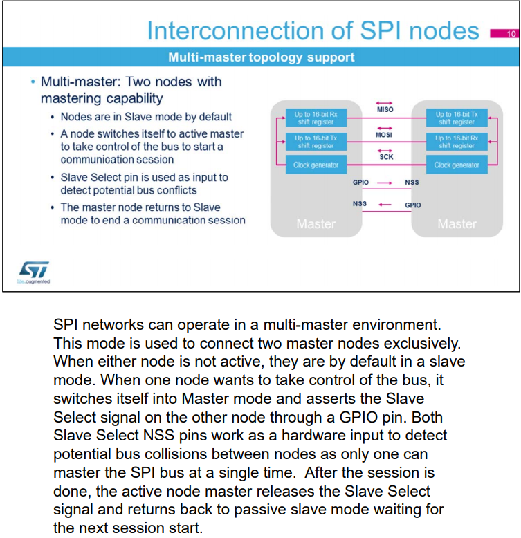

Im trying to implement stm32 spi multi-master function on a stm32f765 according to the below presentation
I keep getting MODF error when transmitting as a master, that would indicate that the slave sets the masters NSS pin low. Even if I set the NSS pin permantently high, by hooking it to a 3,3v pin , I get the same error!

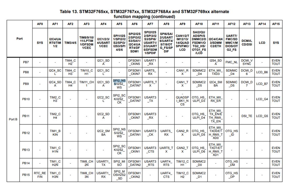

The setup is the one I pasted in the code, the SPI_CS_Pin refers to GPIO_PIN_9 and SPI_CS_GPIO_Port to port GPIOB
and alternate function in use is AF5 according to the table below0693W000003QzClQAK.png

You want the pin to be set to AF in GPIO_MODER, and to proper AF in GPIO_AFR. My guess is, that this:
> GPIO_InitStruct.Mode = GPIO_MODE_INPUT | GPIO_MODE_IT_RISING;
does not do that.

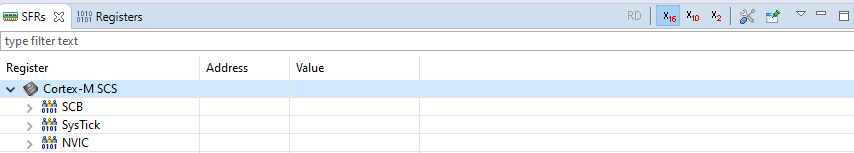

I simply had a break point inside the setup function after the pin config
If your referring to the SFR view, that view does not show the GPIO registers:

We are talking about PB9, so you want to look in MODER at bits 18 and 19 (i.e. 9*2 and 9*2+1 - two bits per pin are used), they are 0b00 which means Input, and are supposed to be 0b10 for AF. Then we would be looking at bits 4 to 9 in AFR[1] (4 bits per pin, that is 32 bits for pins PB0..PB7 in AFR[0] and 32 bits for pins PB8..PB15 in AFR[1].
Having no pin set to AF corresponding to the SPI2_NSS means, that internally that node is set to 0 - which immediately after enabling SPI switches it to slave mode.
