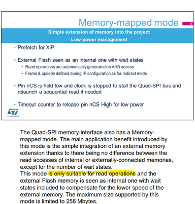

When the QUADSPI interface configured in memory-mapped mode, the external flash memory is seen as an internal memory but with some latency during accesses. Only read operations are allowed to the external flash memory in memory-mapped mode.
The indirect mode supports read and write operations.
For the OCTOSPI interface, the write operation is supported in memory-mapped mode.

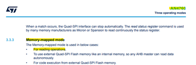

Hi @Priyank,
To clarify my last reply.
"Writing to QSPI Memory Mapped Mode
I am trying to debug some functions to write to the memory mapped QSPI."
->The memory mapped mode is only suitable for read operation (en.STM32F7_Memory_QuadSPI.pdf), so you cannot made a write operation in memory mapped mode.
