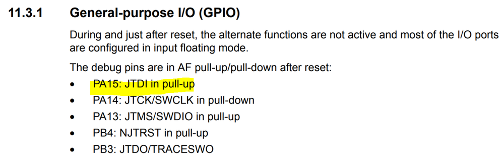

Hi, I had a weird issue with an STM32F334 MCU. A pin was configured as Open Drain - this pin is used for falling edge interrupt and pulled up by a different section of the design. But I had issue today with the operation of the pin and realised the MODER Register read "0x-2". What does this mean please? I have solved this issue by locking the pin, but I just want to know if this makes any sense. I am using Ride 7 IDE.

PA15 is configured with a pullup after reset as it's a JTAG pin.
ambrose
Hi, thanks a million for the response. this is true, but my issue occurs after the application has been running for a while. It actually forces the pin low.

If GPIOx_MODER register changes "spuriously" (which almost always means some bug in code), you can try to catch it by setting a data breakpoint (sometimes called watchpoint) onto the given register.
