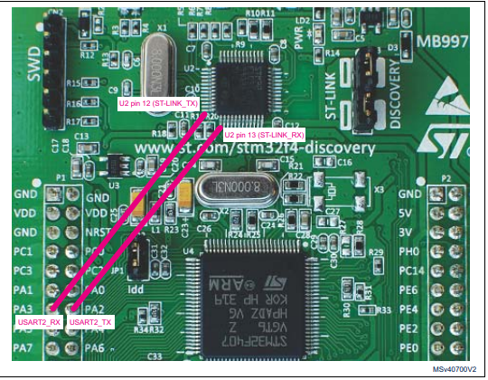

I'm trying to use STM32F407 to develop​ bluetooth audio device. I use the cc2564c bluetooth board and CC256XEM-STADAPT board made by Texas Instruments. Now I need to use UART2 to connect the STM32 board with PC, but the PA2 and PA3 pins are used by the CC256XEM-STADAPT board. I'm trying to find an alternative.
Accroding to ​this artical, I think I should refer to the TWO PIECES OF WIRE part.
Refer to user manual, the PA2/PA3 should be soldered with U2 pin12/pin13.0693W00000JPFVtQAP.png​Is that recommended?
If I do so, that means I can use micro usb to connect the PC with virtual com port and send data through UART2?

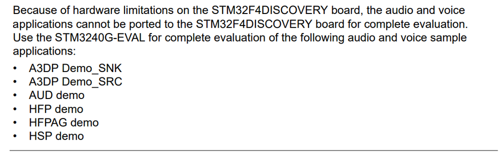

To my knowledge, the STM32F407VG Discovery board is not recommended for audio applications and STM3240G-EVAL is recommended. Should I change to use STM3240G-EVAL?

If you stick to the "two wires", there are alternative pins available. If you develop your software with STM32CubeIDE/CubeMX, you can find it out in the graphical pinout view. You might also use any avail. UART, not only UART2. Check the board schematics to find out how the pins are connected.
Well, the F407 disco is not a new board, that why you have to patch the two wires. Modern boards have the UART connection built-in (ST-LINK v2.1). It all depends on what your software needs to do in the STM32 MCU and what peripherals you need. The EVAL boards carry much peripherals but also a heavier price tag. Think the STM3240G-EVAL is the same generation of boards and has also only ST-LINK v2, not 2.1, so you also have to hand-wire the UART.

As KnarfB said, yes, this board is older and was not updated to connect the serial lines.
But, first, are you sure you have the newer variant, with STLinkV2-1, i.e. do you "see" the virtual COM port in PC?
Why not? And what exactly do you mean by "audio applications"?

If F407 disco is not new, could you give me some advice of a new board? I want to develop a bluetooth audio player, which can connect with phone and play music through speakers.

When I checking the user guide of cc2564c, I found a NOTE as follow,0693W00000JPLy8QAH.pngI need to try some of the Demo, so I want to know if I should buy a new board or not.

The "two wires" connent RX and TX lines from a MCU UART to the ST-LINK debug chip (top). USB_OTG_FS is not involved here, any UART can be used if its RX and TX can be accessed without conflicts. The ST-LINK debug chip then will tunnel the serial data from/to a PC serial (COM) port. This feature was added later and may be not present on your board, see Overview of ST-LINK derivatives - Technical note.

Is that means I could directly connect UART and PC with a new version ST-LINK?
So, if I buy a new board with ST-LINK/V2-1 or newer version of ST-LINK, my problem might be solved?
Sincerely.
Right, using ST-LINK virtual com port facility. But, this is a USB serial port, not an audio class USB device.
