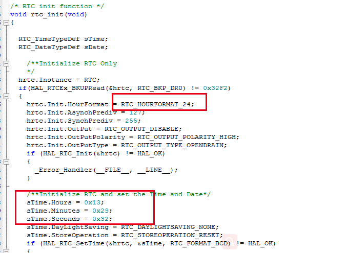

why STM32F401RCT6's RTC HT value can't be zero when over 24:00
ryang
I find the RTC's HT's Value exceeds 24,when i use a stm32f401 mcu's RTC module to upload sensor data to geteway.I'm very confusing.
My project is made by stm32cubemx,and using the newest HAL library.
3 REPLIES 3
waclawek.jan
This happens if you set the RTC to 12-hour (AM/PM) mode (RTC_CR.FMT = 1) and set hour to 13 or higher.
I set the hour to 13 in fact,but don't set the RTC to 12-hour mode.I'll change the hour value to 10 and check again tomorrow.

waclawek.jan
Read out and check the RTC registers content.
