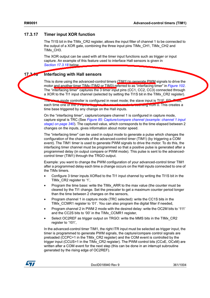

My device: STM32F051R8T6
Dev board, F0 disco.
My end goal is to make a BLDC control system with Hall Sensors and utilize the ability of general purpose timer to trigger the interrupt on hall sensor line edge change.
I am using TIM3 as an interface timer with PC6,7,8 as Ch1,2,3 respectively.
For now, just as a test I am planning to feed only PC6, or ch1 with signal generator square wave with 2ms period (1ms on, 1 ms off). I think that in order to just test the ability to receive edge signal and trigger on it is enough, since according to ref. manual all 3 inputs are XOR'ed, and if 2 inputs kept low, while one is toggling, it should still make TIM3 to trigger.
Below is a code i use for initialization:

This is not a complete code yet, since there must be additional code for handling each of 6 "steps" and changing the OCx. however, at this point it is not necessary since I only test for now the Interface timer triggering.
So, the thing is, after i start it all up and feed PC6 with test signal, the interrupt on TIM3 not happening, any idea?

waclawek.jan
September 23, 2019
You first set CH1 to input capture (the "hall whatnot") and then in turn set it to output compare - output won't trigger on input pulses - contrary, the mcu output and the pulse generator are "figthing" now.
The whole Hall etc. subchapter in the timer chapter of RM is bizarre. It won't belong to the RM, rather, to an AN; and deserves a more thorought explanation with figures etc. No wonder it gets misunderstood.
RRekk
RRekkAuthor
September 23, 2019
well, i am not quiet getting. As far as i udnerstood, you set ch1 to input capture, and ch2 to output compare in PWM mode.

So that function i used in a first posted code, does exactly what the RM says. why is it not triggering then? what am i missing?
waclawek.jan
September 23, 2019
I don't use Cube so don't understand that code, sorry. So you already use two different timers? And you have set up an ISR for TIM3, enabled in NVIC, and set the appropriate interrupt enable in TIM3_DIER?
Read out and check the relevant GPIO, TIM and NVIC registers' content. Observe the effect of changing input levels on the given pin on the respective GPIO_IDR bit. Observe on the respective TIMx_CCR register, whether capture occurs.

well, here is the TIM3 starting code with the interrupt enabling in DIE register:
HAL_StatusTypeDef HAL_TIMEx_HallSensor_Start_IT(TIM_HandleTypeDef *htim)
 /* Check the parameters */
 assert_param(IS_TIM_HALL_INTERFACE_INSTANCE(htim->Instance));
 /* Enable the capture compare Interrupts 1 event */
 __HAL_TIM_ENABLE_IT(htim, TIM_IT_CC1);
 /* Enable the Input Capture channel 1
 (in the Hall Sensor Interface the three possible channels that can be used are TIM_CHANNEL_1, TIM_CHANNEL_2 and TIM_CHANNEL_3) */
 TIM_CCxChannelCmd(htim->Instance, TIM_CHANNEL_1, TIM_CCx_ENABLE);
 /* Enable the Peripheral */
 __HAL_TIM_ENABLE(htim);
 /* Return function status */
 return HAL_OK;
and here is how i actually enable interrupts:
	// enable and configure TIM3 related interrupt
	HAL_NVIC_SetPriority(TIM3_IRQn, 0, 1);
	HAL_NVIC_EnableIRQ(TIM3_IRQn);
	HAL_NVIC_SetPriority(TIM1_BRK_UP_TRG_COM_IRQn, 0, 0);
	HAL_NVIC_EnableIRQ(TIM1_BRK_UP_TRG_COM_IRQn);
So i do enable the TIM3_IRQn interrupt since im using TIM3 as an interface timer,
but upon feeding the PC6 with the test signal (while PC7,8 are at low and inactive), i still dont see any interrupt triggering. even though everything is setup correctly now.

to be more precise, i only set the CC1IE bit there, does it sound right?
waclawek.jan
September 23, 2019
Yes. So have you checked what's actually in the GPIO and TIM registers?

TIM registers have proper settings, yes. and well, its not GPIO anymore it is AF function pin. So according to all settings i should be able to see TIM3 INT triggering.
what specifically you meant me to check?
waclawek.jan
September 23, 2019
Read out their content in debugger or in any other means, and check, whether they contain what you intend to.
Also you should observe whether respective GPIO_IDR reacts to changes of the input signal; then you can also check if TIMx_CCRy captures the counter value upon appropriate change of the input signal; and observe the interrupt flag to be set in TIMx_SR.
