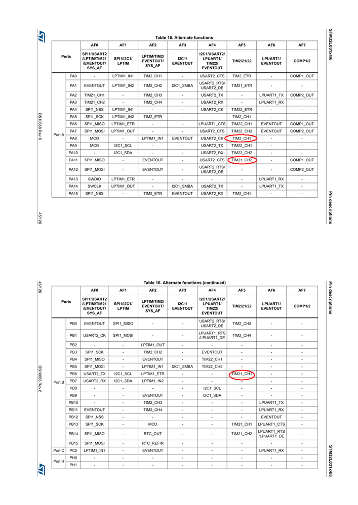

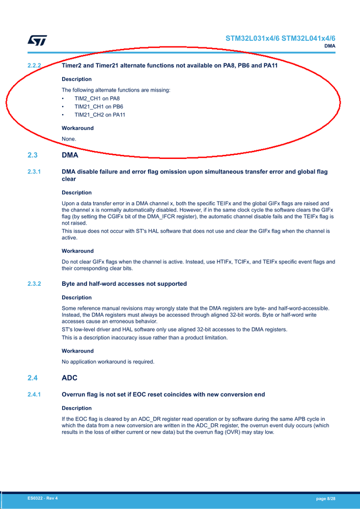

Why are missing features still present in DS? Answer: It only pertains to an old revision of the chip.
waclawek.jan
0693W00000LvVq1QAF.pngyet
and of course also in the pins table.
Why??
OK I take it back - this is pertinent only to rev.A of the chip; there are newer revisions where this (and other rather disturbing errata) is already fixed.
