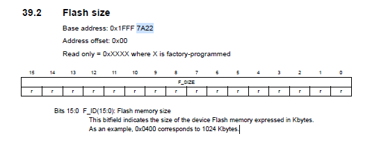

Our design and firmware used to work with former batch but a current lot of STM32F427 does not have a proper readout of the flash size and does not switch from bank A<->B.
The STlink reads the following on a working chip:

The register 0x1FFF7A22 should be factory-programmed but reads 0xffff instead of 0x0800 !
0693W00000WKpdMQAT.pngThe DBGMCU_IDCODE, Address: 0xE004 2000, suggests a die revision 3 (20 01) in the first working chip and a die revision 5 or B for the second one (20 03).
Could the die revision affect the dual bank features?
Can the flash_size be overwritten?
Or should I think of a clone chip?
Thanks for your inputs!
More of a case of the System Memory NOT being written, which is often the case for Engineering Samples. This could be the case where a mask-set has been brought up at a new fab. I think some of the F4 that previously came out of a French fab, now come out of one in Taiwan as well.
You should perhaps open an Online Support Request via the support portal.
This looks to be a similar situation with a part out of TSMC 14 Taiwan, there's been at least one other report I've seen within the last few weeks, or month, but the search engine here is dire..
