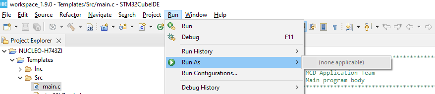

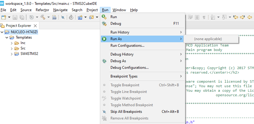

mƎALLEm
You have to click on the project "NUCLEO-H743ZI" in the "Project Explorer" before going to Run, Run As ..
Hi, I did, it still doesn't work.

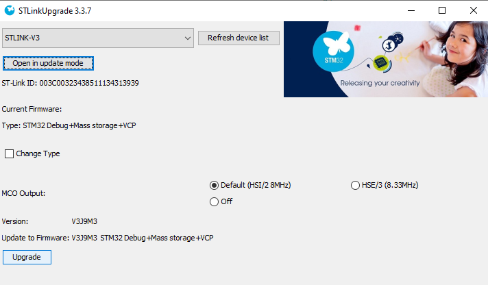

Hi.
I can update the firmware via Help > ST-LINK Upgrade
0693W00000LvYdtQAF.pngSo I suppose the board is recognized.

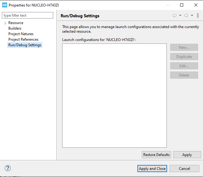

I didn't find Project Properties.
In case you meant: Project > Properties.

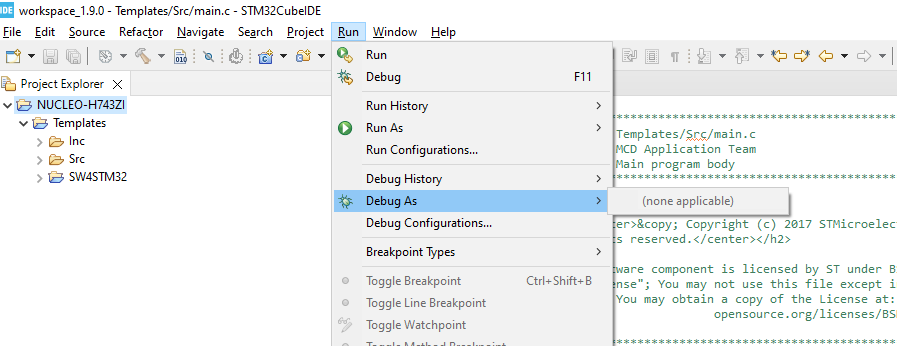

0693W00000LvYbEQAV.pngThere is no "Debug As...> STM32 Cortex-M C/C++ Application"
In case you meant: Run > Debug As...
0693W00000LvYcvQAF.pngI have nothing.
As I see from your screenshot, you did import a project from system workbench to CubeIDE but may be you didn't it correctly.
I suggest to follow the wiki provided in this link / 2 Import an SW4STM32 project without an ioc file.

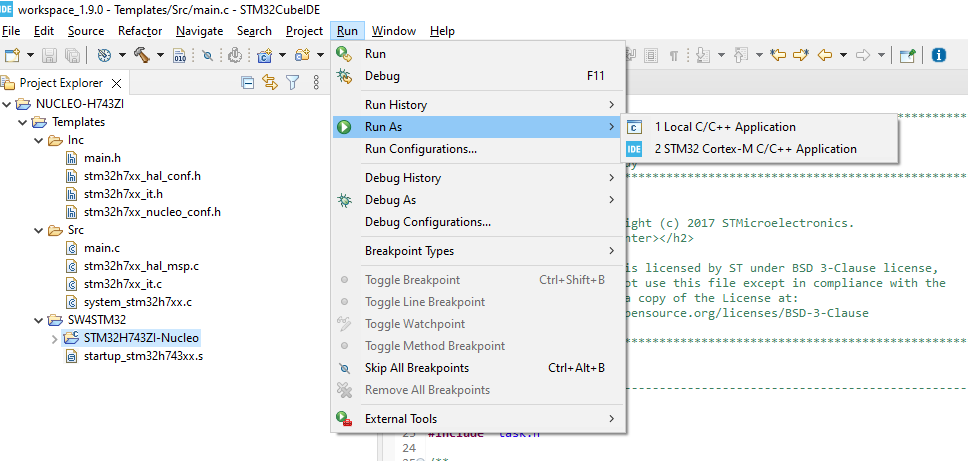

Thanks for your time. I can't confirm your answer worked, but I found that by clicking on STM32H743ZI-Nucleo it worked.
