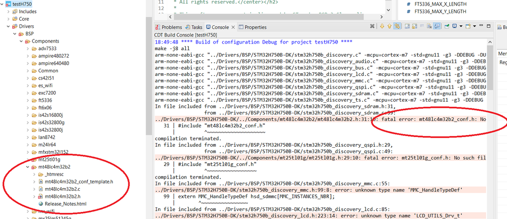

I got these Errors upon compilation:
../Drivers/Components/mt25tl01g/mt25tl01g.h:29:10: fatal error: mt25tl01g_conf.h: No such file or directory
  29 | #include "mt25tl01g_conf.h"
compilation terminated.
make: *** [Drivers/Components/mt25tl01g/subdir.mk:19: Drivers/Components/mt25tl01g/mt25tl01g.o] Error 1
make: *** Waiting for unfinished jobs....
In file included from ../Drivers/Components/ft5336/ft5336.c:22:
../Drivers/Components/ft5336/ft5336.h:32:10: fatal error: ft5336_conf.h: No such file or directory
  32 | #include "ft5336_conf.h"
In file included from ../Drivers/BSP/STM32H750B-DK/stm32h750b_discovery.c:25:
../Drivers/BSP/STM32H750B-DK/stm32h750b_discovery.h:33:10: fatal error: stm32h750b_discovery_conf.h: No such file or directory
  33 | #include "stm32h750b_discovery_conf.h"
same error when mt48lc4m32b2 is included before removing the file.

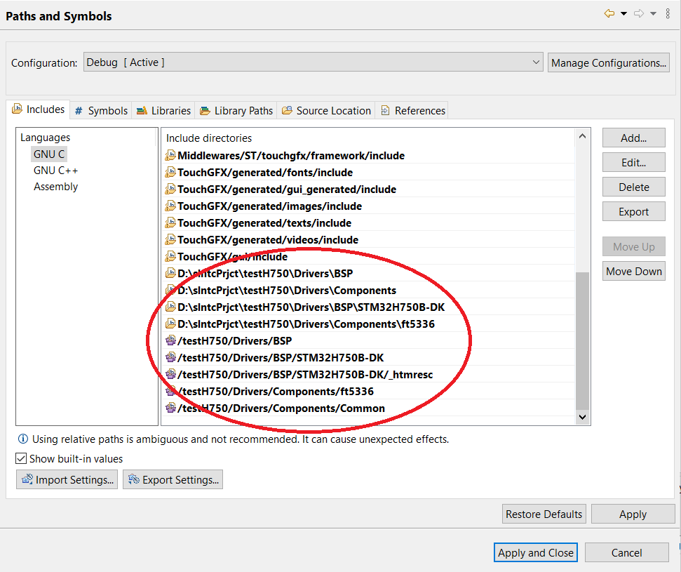

Hello @ksale.1​ ,
The issue it can be in the include paths.
Check the project properties/options -> Include paths tab, then add new paths to your include directories.
Hope my answer helped you!

Hello @Imen DAHMEN​
The directories are already in the paths as you mentioned,. The problem is the config files do not exist in the H7 MCU Package v1.10.0. I'm currently deleting/re-installing the package.

The file names are templated as in the below screen shot, while the compiler is complaining about ...config.h not found! You help is greatly appreciated
