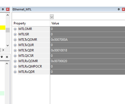

The following figure shows the memory contents of the Ethernet send buffer in the exception case:

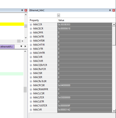

The following figure shows the register values of the Ethernet MAC part in the abnormal case:
The MAC registers are configured identically to the normal MAC registers, except that they cannot send data.

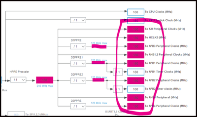

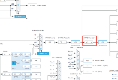

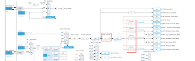

The problem has been identified. When using the STM32H7, I reduced the main frequency to 160 MHz, and for the HPRE division, I chose 1. As a result, the peripheral clock is also 160 MHz. As shown in the following figure:

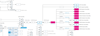

The CubeMX project mentioned above uses an older version of the HAL. If the new HAL library is used, CubeMX will automatically generate an error message, as shown in the following figure:
After verification, it was found that if the HPRE frequency division is set to 2 or higher, all Ethernet functions operate normally.
But I still don't understand why. According to the instructions on CubeMX, the maximum peripheral clock can be set to 240 MHz. The 160 MHz I have set here should be within the valid range.
As the picture shows, in your situation the APB1/2/3 inputs are out of limits (120 MHz max.)

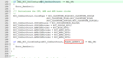

This is the configuration I used. I set the HPRE pre-frequency division to 1. After turning off the Cache, the program could not run normally, but when the Cache was turned on, it could run normally. If I set the HPRE pre-frequency division to 2, the switch of the Cache had no effect on the program's operation. However, after turning on the Cache and making the relevant modifications mentioned in the previous problem regarding dw3000, the problem of Ethernet unable to send data still existed. Later tests revealed that the delay time of Flash during RCC initialization affected the sending of Ethernet. If as shown in the following figure:
If I change FLASH_LATENCY_1 to FLASH_LATENCY_2, and with the Cache enabled, the Ethernet can function normally for data transmission.
