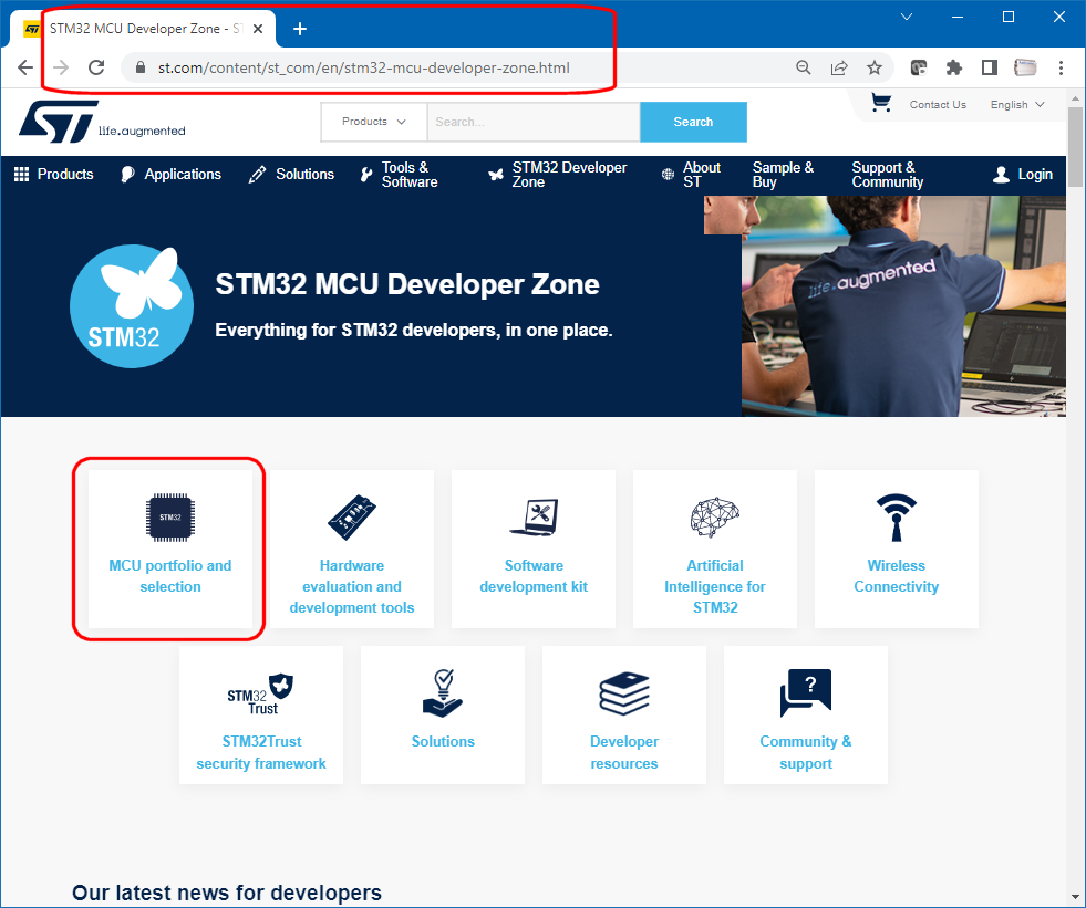

Have you tried the "STM32 Finder new mobile app" ?
https://www.st.com/en/microcontrollers-microprocessors/stm32-32-bit-arm-cortex-mcus.html#st-highlight-promotion
Or the Product Selector?
