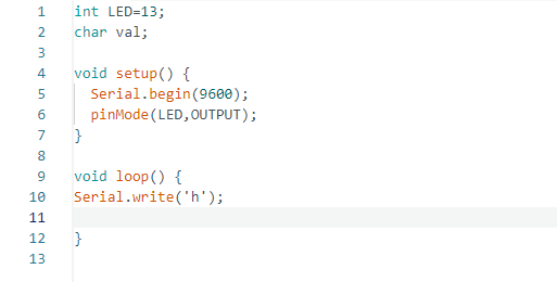

I am trying to establish Serial communication between Arduino and Nucleo-f411re,
I have connected the TX of Arduino to PA10 (UART 1 RX) of the Nucleo, I have tried using a voltage divider also but t did not work
Nucleo code

the arduino code
thanks in advance

"I have connected the TX of Arduino to PA10 (UART 1 RX) of the Nucleo"
and ground?
Is PA10 (UART 1 RX) of the Nucleo shared with any other hardware on the Nucleo; eg, the ST-Link?
Before bringing them together, have you tested your serial comms on each board in isolation?
See my post this morning in this thread - about trying to do both ends of a link at once:
‎2022-07-25 11:58 AM
“and ground?�?
Yes, I have connected both ground and 3v3 together.
“Is PA10 (UART 1 RX) of the Nucleo shared with any other hardware on the Nucleo; eg, the ST-LINK�?
no, the USART 2 Is shared with ST LINK, USART 1 is not shared with anything.
“ Before bringing them together, have you tested your serial comms on each board in isolation?�?
Yes, the arduino communicates with other Arduino withno problems at all, and and the nucleo board communicates with laptop using realterm with no problems
‎2022-07-25 12:57 PM
@IHJEI.1​ "arduino communicates with other Arduino withno problems"
But that could mean that you have the same error on both Arduinos - so they "cancel out"
Have you tested the Arduino with the laptop?
‎2022-07-25 11:45 PM
Most new stm32 have autobaudrate and rx tx pin swap. Make sure you use stm32 pin not tied to stlink, and that they are 5v tolerant (datasheet pin table). An oscilloscope saves time in the bringup phase, borrow one.
‎2022-07-26 12:46 PM
Yes the serial monitor works perfectly
