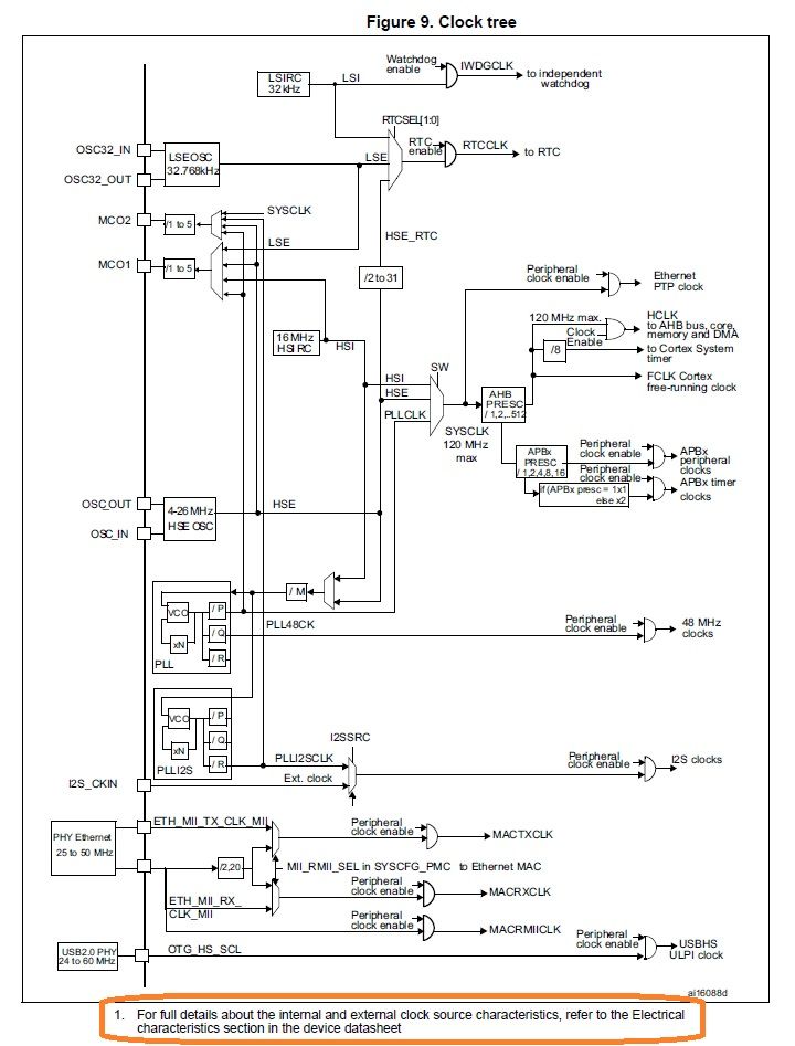

There is typical a Clock Tree diagram, a diagram of which TIM/peripherals are on which bus, and the RCC_APBxENR registers also infer which TIM is on each bus based on which bus clock that needs to be enabled.

Arbitrary timer A... WHERE is diagram showing which peripheral is on which clock tree?
I just found the timer clock sources in tabular form in the datasheet (not in reference manual where I searched).

ST likes diagrams for the kidz that can't read good and stuff, here from a Reference Manual for an arbitrary STM32 part.
Other STM32 parts, where the RM covers a few dozen varied ICs, you get referred to the DS
but also
Yup, missed that bit in the Device Overview block diagram...

CubeMX can show the clocks tree very nicely, if you use it.

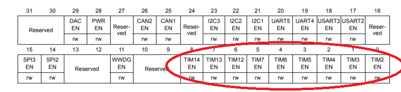

You may have a look on "RCC_APB1ENR" and "RCC_APB2ENR" registers in the reference manual.
Example: "RCC_APB1ENR " register shows the peripherals connected to the APB1 bus (screenshot taken from STM32F2 RM).
