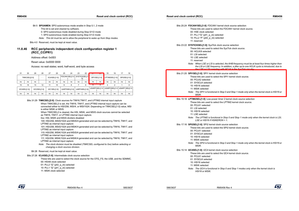

According to the STM32U585 documentation, there is supposed to be a SP1 clock mux selection register, but none is described in the latest programming manual.
Does anyone have any idea on what bits I need to set in which register to select the MSIK clock for the SPI1 peripheral?

‎2023-03-26 2:27 PM
2 REPLIES 2
Options
‎2023-03-26 2:27 PM
Options
‎2023-03-26 2:36 PM
Great, thank you! Exactly what I needed.
