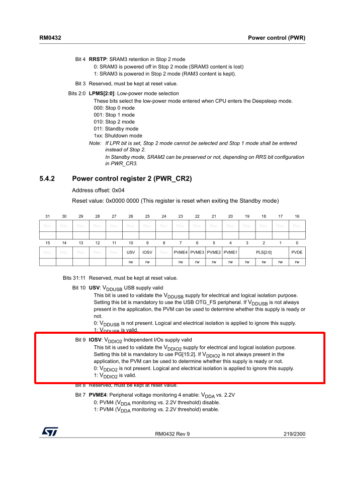

NUCLEO-L4R5ZI board CN12 header Pin76 = PG7, pin66 = PG8, config as GPIO output pins, but cannot toggle these two pins, SB130 and SB131 have been removed from the board.
HYuan.1
NUCLEO-L4R5ZI board, CN12 header: Pin76 = PG7, pin66 = PG8.
config PG7, PG8 as GPIO output pins, but cannot toggle these two pins
Here is the code:
 GPIO_InitTypeDef GPIO_InitStructure = {0};
 __HAL_RCC_GPIOG_CLK_ENABLE();
 GPIO_InitStructure.Pin =  GPIO_PIN_1 | GPIO_PIN_7 | GPIO_PIN_8;
 GPIO_InitStructure.Mode =  GPIO_MODE_OUTPUT_PP;
 GPIO_InitStructure.Pull = GPIO_NOPULL;
 GPIO_InitStructure.Speed = GPIO_SPEED_FREQ_VERY_HIGH;
 HAL_GPIO_Init(GPIOG, &GPIO_InitStructure);
 HAL_GPIO_WritePin(GPIOG, GPIO_PIN_1, GPIO_PIN_RESET);  // set to LOW,  OK
 HAL_GPIO_WritePin(GPIOG, GPIO_PIN_1, GPIO_PIN_SET);  // set to HIGH, OK. PG1 toggles OK.
 HAL_GPIO_WritePin(GPIOG, GPIO_PIN_7, GPIO_PIN_RESET);  // LOW.  PG7 always low
 HAL_GPIO_WritePin(GPIOG, GPIO_PIN_7, GPIO_PIN_SET);   // set to HIGH, PG7 always low (measured), cannot set to high!
 HAL_GPIO_WritePin(GPIOG, GPIO_PIN_8, GPIO_PIN_RESET);  // LOW.  PG8 always low
 HAL_GPIO_WritePin(GPIOG, GPIO_PIN_8, GPIO_PIN_SET);  // set to HIGH, PG8 always low (measured), cannot set to high!
Note: (1) PG0, and PG1 pins can set/toggle correctly.
   (2) PG7 and PG8 cannot set/toggle correctly.
Thanks.
waclawek.jan
PG2 to PG15 pins are supplied not from VDD but from VDDIO2, and you have to switch the VDDIO2 domain on by setting PWR_CR2.IOSV

waclawek.jan
HYuan.1
Thanks for help. This issue is solved by calling  "HAL_PWREx_EnableVddIO2();"
as JW pointed out "PG2 to PG15 pins are supplied not from VDD but from VDDIO2, and you have to switch the VDDIO2 domain on by setting PWR_CR2.IOSV"
