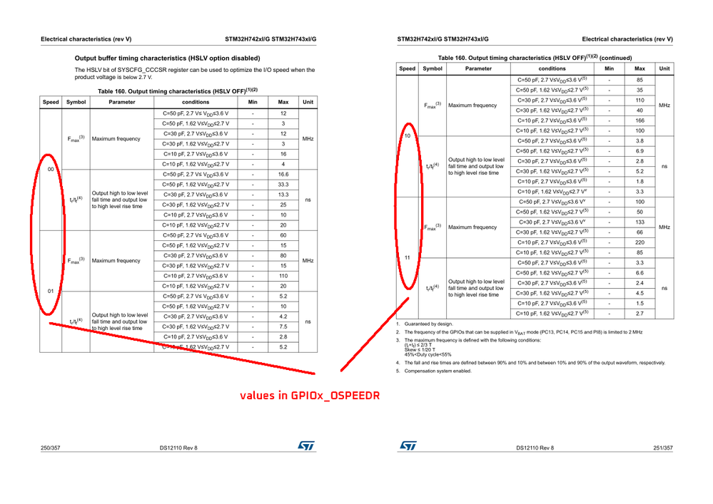

Hello @BNord.1​,
As mentionned, The rise time (tr), fall time (tf) and maximum frequency are configurable using the GPIOx_OSPEEDR configuration register as following :
00 => Low : Fmax = 16 MHz
01 => Medium : Fmax = 110 MHz
10 => High : Fmax = 166 Mhz
11 => Very High : Fmax = 220 MHz
However, Such adjustment has an impact on the EMI (electromagnetic interferences), so a compromise has to be done between GPIO performance versus noise, it is best to adapt the GPIO signal to the minimal value compatible with the associated signal frequency.
You can always refer to the GPIO Application Note for further information :  STM32 microcontroller GPIO hardware settings and low-power consumption - Application note
