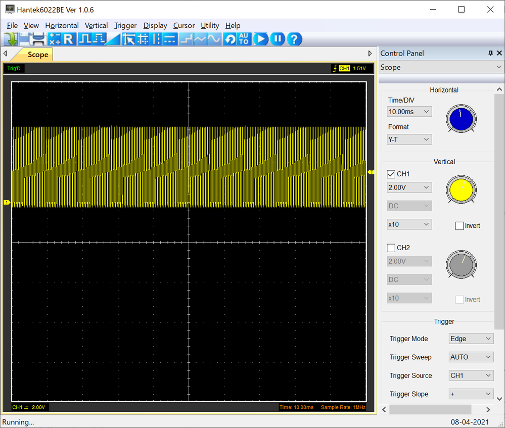

When I start STM32G031J6(SO8N) PWM, the code jumps to label "Reset_Handler".
EMori.1
I generate the STM32 Project and define each PIN.
PIN1:GPIO_Output
PIN4:TIM2_CH1
PIN7:SYS_SWDIO
PIN8:SYS_SWCLK
And I let a code below run but it do not reach "while".
 MX_GPIO_Init();
 MX_TIM2_Init();
 /* USER CODE BEGIN 2 */
 HAL_TIM_PWM_Start(&htim2, TIM_CHANNEL_1);
 /* USER CODE END 2 */
 /* Infinite loop */
 /* USER CODE BEGIN WHILE */
 while (1)
  HAL_GPIO_WritePin(GPIOC, GPIO_PIN_14, GPIO_PIN_SET);
  HAL_Delay(10);
   HAL_GPIO_WritePin(GPIOC, GPIO_PIN_14, GPIO_PIN_RESET);
   HAL_Delay(10);
  /* USER CODE END WHILE */
   /* USER CODE BEGIN 3 */
 /* USER CODE END 3 */
I run and investigate the code in step, and the code jumps to "Reset_Handler:" at the line "__HAL_TIM_ENABLE(htim);" in the API "HAL_TIM_PWM_Start".
0693W000008ywMMQAY.pngThe code repeats execution and reset. The GPIO pin is as above.

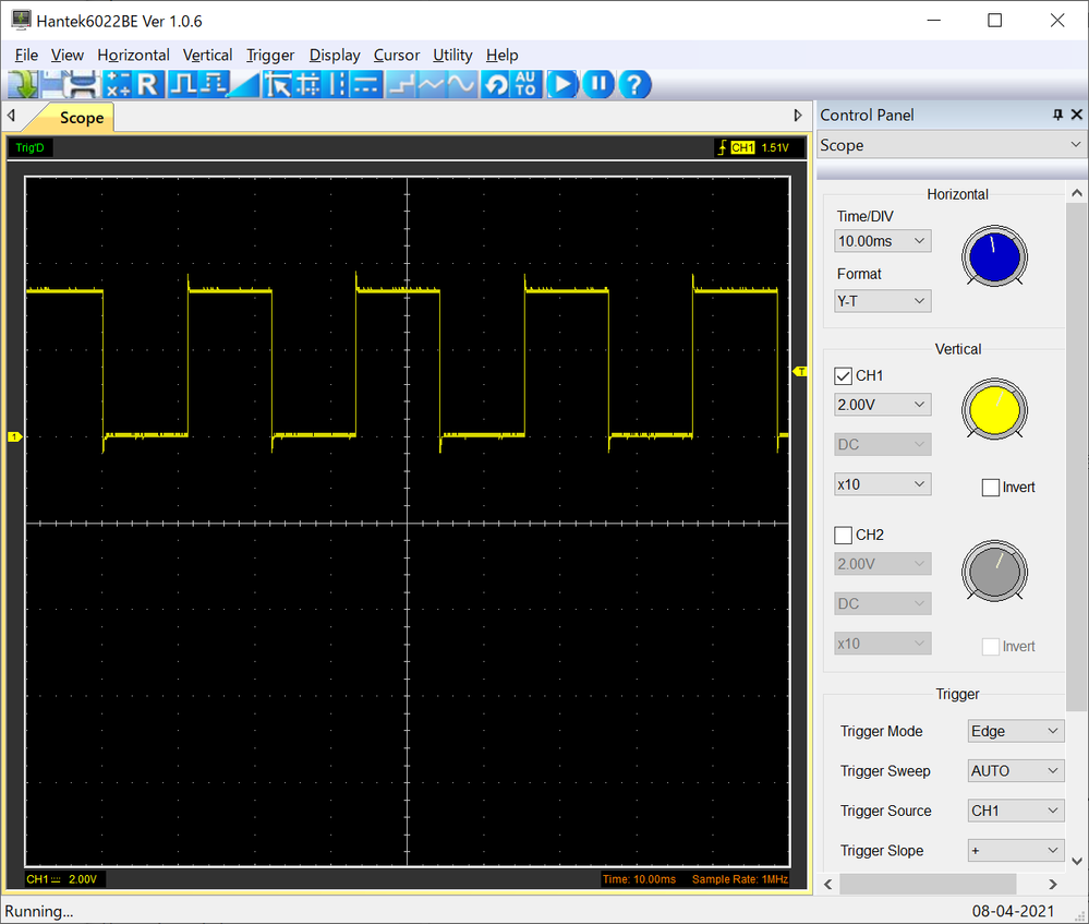

If I comment out "HAL_TIM_PWM_Start(&htim2, TIM_CHANNEL_1);" in the above code, it reach "while" successfully. The GPIO pin is as follows.
0693W000008ywMRQAY.pngI set my project as default except for each PIN and TIM2. I set TIM2 Channel1 to "PWM Generation CH1".
Do I miss any necessary setting?
