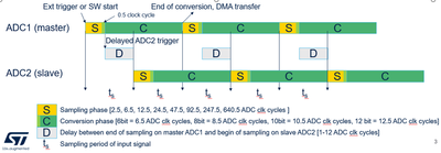

From the calculation here atthe bottom: Stm32 Interleave
I calculated as
2.5cycle sample(Adc1) + 2.5 cycle delay + 2.5cycle sample(Adc2) + 8.5 cycle conversion(Adc2) = 16 cycle for 2 samples
Am I doing it wrong? Thanks for the answer and I hope you are right.
‎2025-06-25 2:51 PM - edited ‎2025-06-25 2:53 PM
There are 16 cycles between the start of ADC1 sampling and the end of ADC2 converting, but ADC1 has already started sampling again by that time so it's not a useful measure of effective sample rate. The delay doesn't affect things here because it doesn't cause a slowdown. ADC1 is ready to sample again immediately after it's done converting.
Calculate the time between ADC1 taking a sample and then ADC1 taking the next sample. That's 2.5 + 8.5. You get two samples during that time (one from ADC1, one from ADC2).
If you increase the delay from 2 to something larger, eventually it starts to affect things. At 4 or more sample rate will slow down. (2.5 + 4 + 2.5 + 4 = 13, which is more than 11)

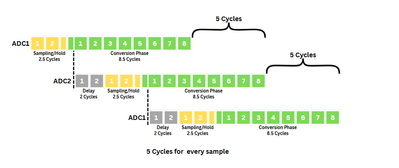

Thank you, also sorry for the calculation problems again but I tried to calculate the ADC t_s using the difference where ADCs conversion phases end as it is implemented here:
This is my version's calculation:
According to this, the time difference between 2 samples should be 5 cycles? Hope not doing anything wrong this time tho
‎2025-06-27 7:04 PM
Shift the second ADC1 over to the right 1 cycle. It can't sample until it's done converting.
