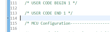

When I make debug, program steps appear where there are no brekpoints.
‎2022-02-17 7:05 AM
When I make debug, program steps appear where there are no brekpoints. It shows the debug steps in the description lines.
Solved! Go to Solution.

May be the relics of and older version of your prog. Delete those breakpoints and/or make a clean rebuild.

When you have a breakpoint, but the breakpoint is commented out (or moved by adding another breakpoint or a lot of comments), the code often stops at the active code location nearest the breakpoint (that can''t be reached).
Checking the breakpoint list may tell you what's triggering what. If a breakpoint comes up in the middle of a set of comments, well, it gets close.
