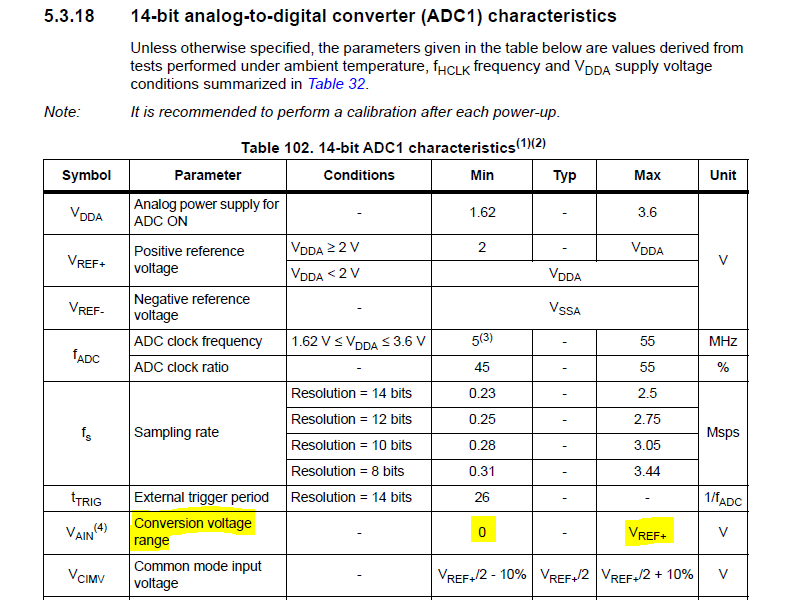

‎2022-09-22 1:13 AM
Hello @Andreas Köpke​ ,
Thank you for sharing your request :) .
On STM32U5 devices there is supposed to be no Voffest on the ADC1.
As indicated in the datasheet section 5.3.18 "14-bit analog-to-digital converter (ADC1) characteristics" if your VREF- is connected to VSSA and to the ground, the conversion voltage range for ADC1 is VSSA (0V) ≤ VAIN ≤ VREF+
Please find in attached the datasheet.
Best Regards,
A.MVE

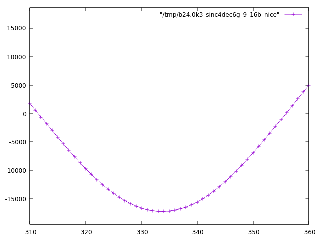

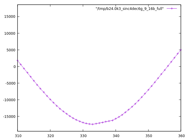

‎2022-09-22 1:30 AM
Below 15mV it's not linear anymore. That's what I get from my measurements. My setup is:
- Generate a sine wave using DAC1 on PA4 from 0 to full scalb24_0k3_sinc4dec6g_9_16b_full(in my case 1.5V after modifying the B-U585I-IOT02A)
- Sample it back on ADC1
- Filter it
- Plot the result
As you can see, it is not a perfect sine wave, it has an "indentation" when the input signal is close to 0V. In contrast, if I limit it to 15mV, I get
a nice sine curve.

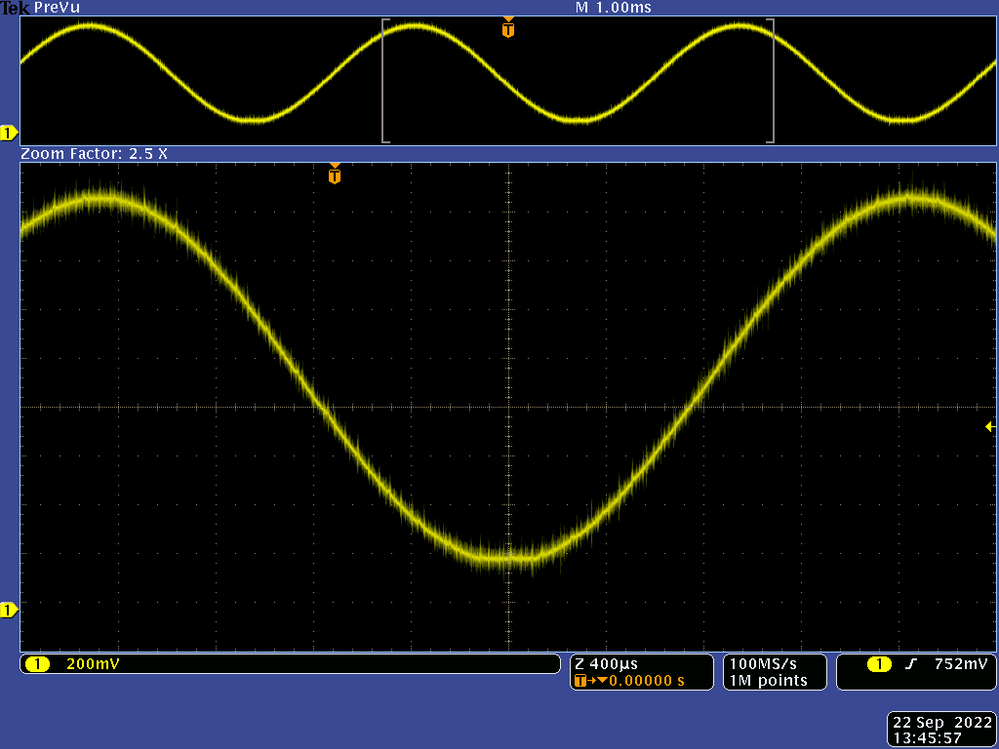

‎2022-09-22 2:14 AM
Thank you for your response.
Can you try to observe directly the DAC1 output with an oscilloscope ?
If the issue is coming from the DAC1 you will be able to observe the same behavior.
Best Regards.
A.MVE
‎2022-09-22 2:29 AM
‎2022-09-22 2:31 AM

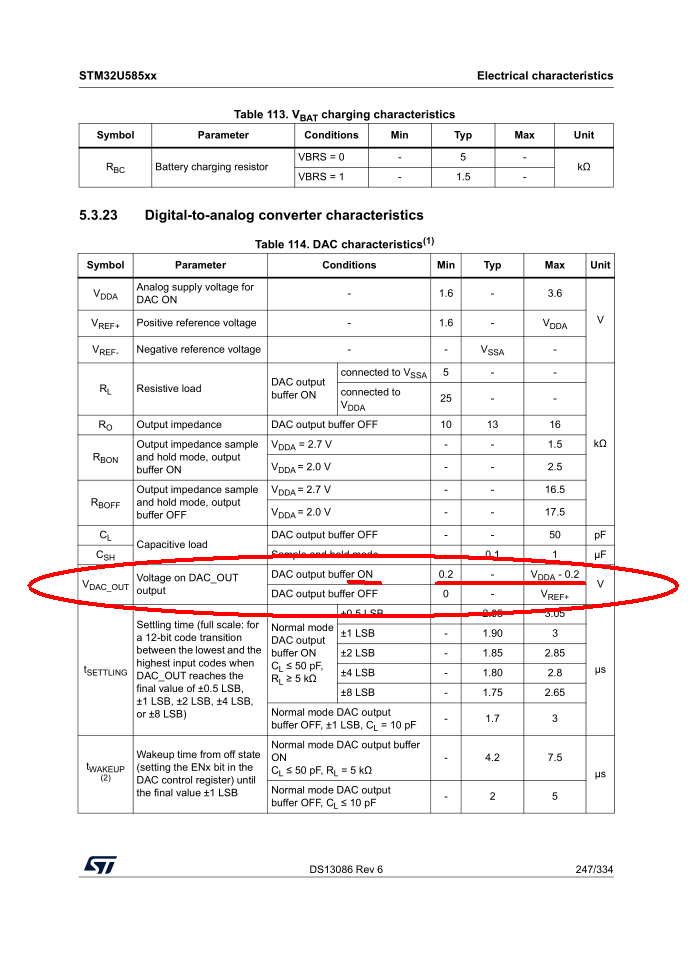

‎2022-09-22 5:08 AM
In the gory details, you've forgotten to mention whether you use the DAC buffer or not. That buffer is known not to go rail-to-rail in the STM32.
PS. Please don't edit your initial post except typos, or do it in conspicuous way, so that rest of the thread won't go out of context.
‎2022-09-22 5:10 AM
I use the buffer, looks like the 0.2V is a rather conservative estimate.
‎2022-09-22 8:47 AM
In my setup, it DAC1 on PA4 does reach rail. Difference from 1.5 is < 5mV. Only the lowest 10 values or so are saturated.
