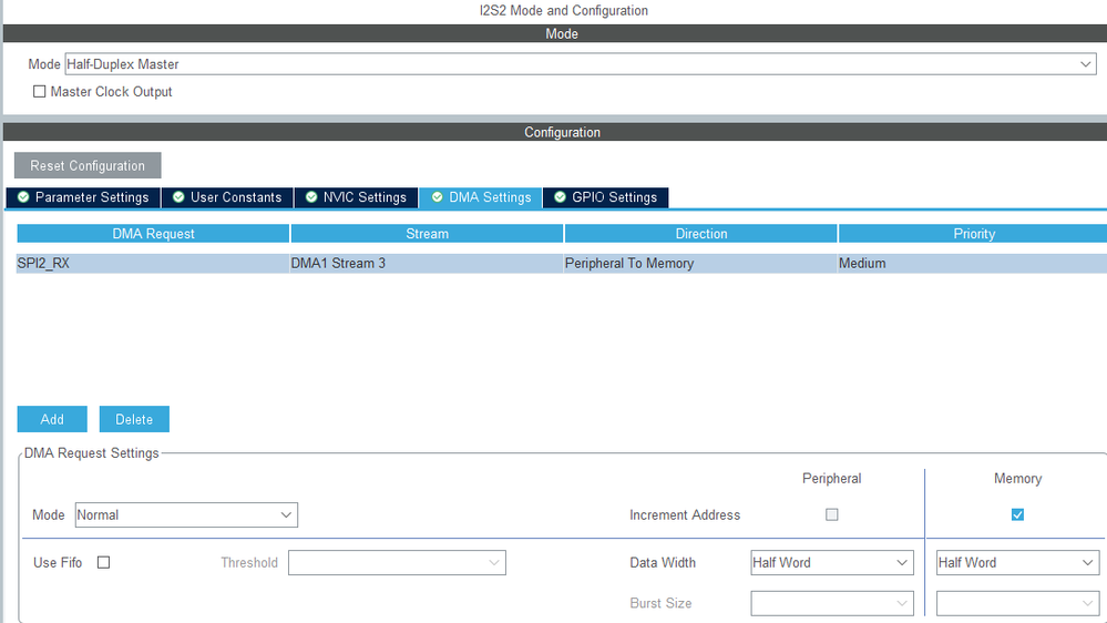

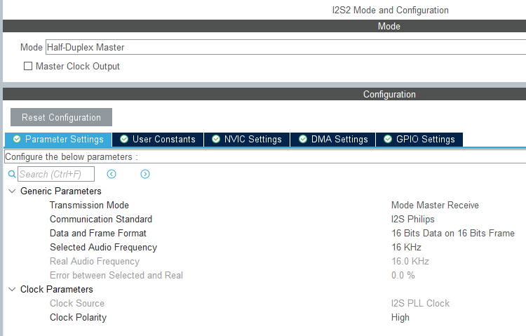

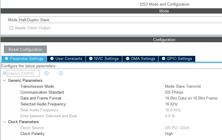

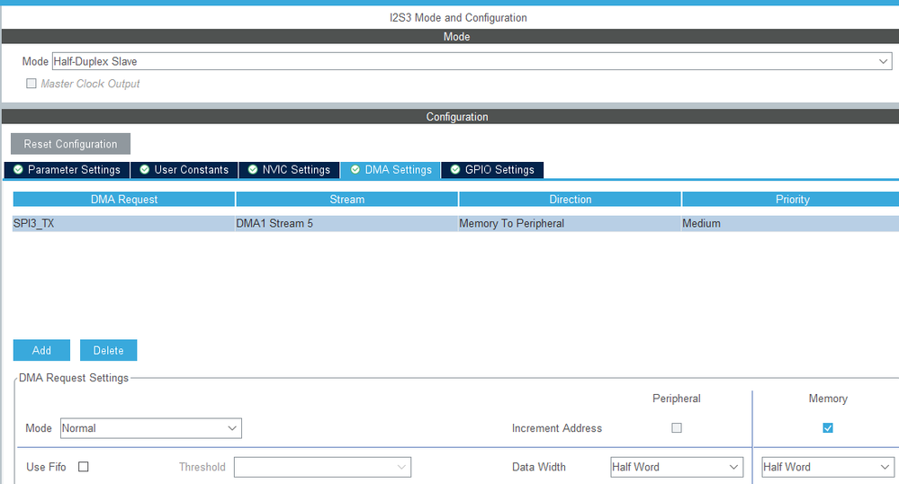

CubeMX Setup:
Master RX Parameter setting and DMA
Slave TX Parameter setting and DMA

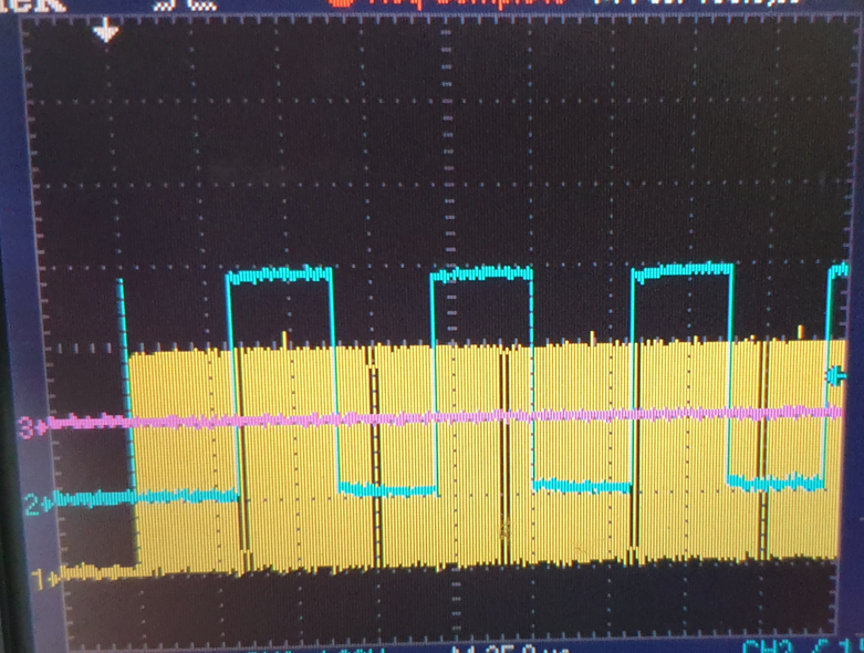

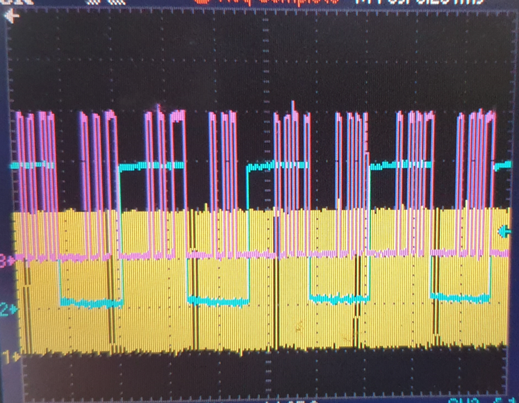

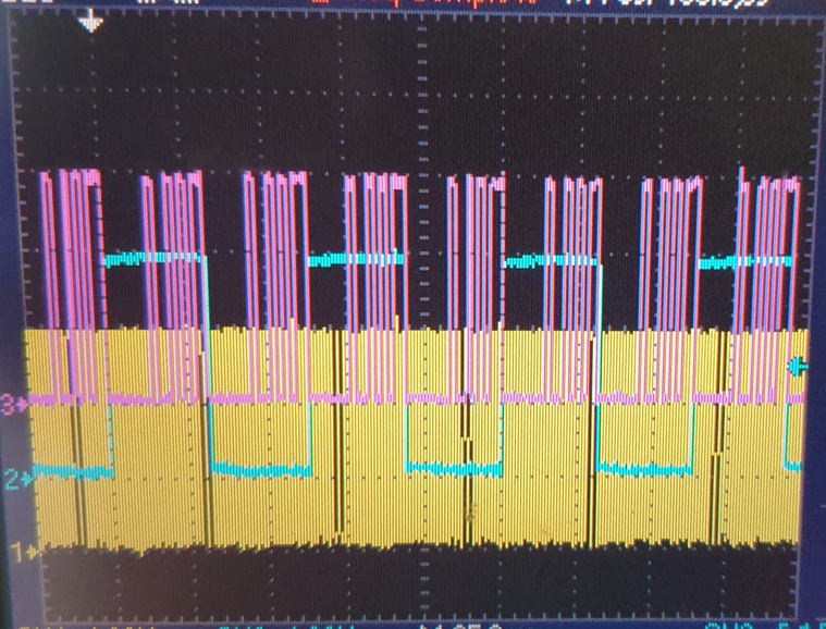

Waveforms:
Similar to Q1 above. When connected normally all is ok. But when WS of Slave TX is connected to GND, still the same waveform, I expect only Left or Right to be transmitted.
The data shown is the beginning of the data, where SD pin is transmitting 0 - 6.
CH1 Yellow = CK
CH2 Blue = WS
CH3 Pink = SD
Similar to Q2-3 above. I2S is still sending data even after the last data (299), the data being transmitted is always 299 0x012B.
Before the last data is sent (299), the data is still incrementing to 299. The last 2 data are not 299 and same.
Similar to Q5 above. WS pin on the Slave TX is held high. The WS waveform below is from Master RX.

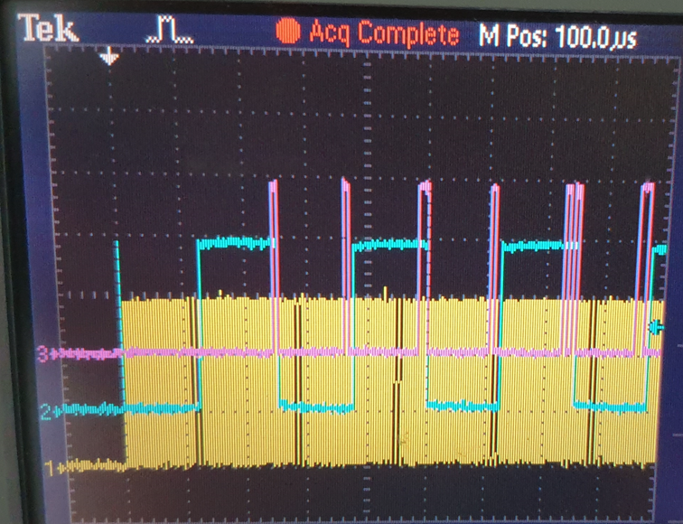

4. If I pull low the WS of the Slave Transmitter, the received data seems to be shifted, [0, 2, 4, 6, 8, ...... 596, 598] instead of [0, 1, 2, .... 288, 289]. But checking the waveform as shown below, the data within WS frame is correct. Does this mean that the Master RX is the one shifted?
CH1 Yellow = CK of both Master RX and Slave TX
CH2 Blue = WS of Master RX, while Slave TX is pulled low.
CH3 Pink = SD of both Master RX and Slave TX
‎2022-09-22 10:11 AM
> Why I2S do not stop after the DMA? It is still sending the last data.
What is "after the DMA"? Look into the Cube/HAL functions. Do they disable I2S? No? Then as long as there is clock, I2S wants to transmit something, and if you don't overwrite its data register, it keeps sending the same data over and over.
Cube/HAL - and any other "library" - inevitably supports only a limited subset of all possible combination of functionalities, what the authors deemed "usual", and what can be easily clicked in CubeMX. If you want the mcu to do something else, write your own code.
Then don't pull low the WS. The I2S module expects to see WS high at the moment when it's enabled, and then a falling edge. If you don't provide the expected waveform, it behaves unpredictibly.
