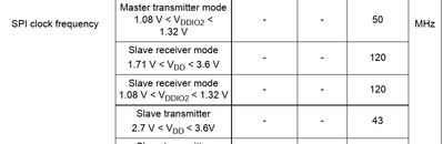

As shown in the above figure, when the speed set by the spi master exceeds 11M, the data sent by the slave appears to have lost bits
AScha.3
from ds :
so 120MHz max.   ; how long are the wires ? ground /shield ? damping resistors ?

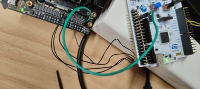

May I ask which document should I refer to for this image? I am using a DuPont cable, and the master and slave devices use the same ground

The physical connection is shown in the figure above.
The logic level is all 3.3v.

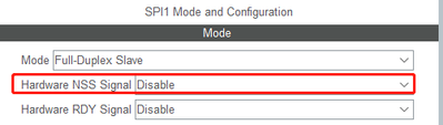

NSS has always been low, but it is not used in firmware
