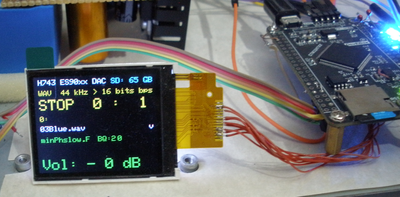

see, here my connection H743 to a tft display, by SPI at 48Mhz clk , no errors !
but short wires, close together and 3x ground , port speed "medium" - and no other ground to somewhere...
you have more than one ground to the boards (by usb - to pc ), this can make also problems.
