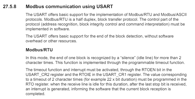

I am implementing a Modbus Master on a STM32F722.
First, transmissions and receptions were managed through Rx/Tx interrupts. But as I got a lot of overrrun errors while getting my slave's responses, I decided to transfer received packet through DMA to my Rx buffer to avoid microcontroller's overuse. As my board is a modbus master, I use RTOR to generate an interrupt when slave finished its transfer, as adviced in STM32F7's reference manual. Here is my initialisation function:

Note: do not take care about DMA configuration for Tx. In practice it is not used
As I am in half duplex, I enable Rx reception as soon as transmission is complete :
case MODBUS_STATE_CORE_MASTER_FRAME_SEND:
if(DataRS485->Config.EmissionTrameEnCours == 0)
DataRS485->ModbusCoreState = MODBUS_STATE_CORE_MASTER_FRAME_WAIT_REPLY;
// lancement de l'ecoute pour la reception
startRxDma();
break;
with
void startRxDma(void)
// set timeout on idle
MODIFY_REG(huart2.Instance->RTOR, USART_RTOR_RTO, MODBUS_TIMEOUT_IN_BITS);
// enable timeout IT
SET_BIT(huart2.Instance->CR2, USART_CR2_RTOEN);
HAL_UART_Receive_DMA(&huart2, RS485Master.RX, UART_RX_BUF_SIZE);

Thank you for your reply. The function Handle_UartFrame_ForModbus_RxCpltCallback is just setting high-level variables, so it can not be the cause of my trouble.
In the meanwhile, I found that there were still overrun errors, but I did not see them at first glance. I found that they were due to the fact that I did not start modbus reception immediately after having finished transmission, but at next main loop. And as the microcontroller is overloaded, I may miss answers from my slave. After having started UART Rx DMA transfer in my Tx complete callback, I succeded to remove overrun errors.
But I am still getting troubles receiving my 3rd frame: the byte count I am getting in HAL_UART_RxCpltCallback (called when DMA transfer is complete) is not correct, although the received frame is the expected one in the Rx buffer.
After having set a breakpoint in this function, I saw that it was called during UART transmission, so it was returning the size of previous received frame. Seems like I am still getting synchronization errors in my code...
2024-05-28 12:16 PM

Hi Karl,
I do not know the size of the data I am receiving. It depends on the frame I am sending before, and the response type of my slave (OK/Error). That is why I am using RTOR to detect end of frame, as adviced in ST32F7xx's reference manual:
This is done in my startRxDma() function. The only difference between now and my first post is that I moved its call in UART's transfer complete callback, and added check of HAL's return state:

Modbus is a master/slave protocol, where slaves can "speak" only when master is sending them a question, so I am expecting only a packet from my slave (no continuous streaming). Moreover, reception and transmission cannot be done simultaneously, as my hardware is half duplex, ie transmission and reception are done on the same line. So I enable reception only after the end of transmission of a packet.
Which callback are you talking about? There are so many...
Received packets are supposed to be transfered to Rx buffer (RS485Master.RX) thanks to DMA as soon as they arrive in UART's reception register, and I do not need circular buffer mode, as I am only expecting one frame per reception, as stated in my DMA's initialisation function (please look at my first post).
UART will fire a receiver timeout interrupt when an idle state of 24 bits length (value of MODBUS_TIMEOUT_IN_BITS) is detected on the line after the reception of the last character. My HAL_UART_IRQHandler will handle it:

As explained in STM32F7's reference manual, DMA transfer may continue after a software disabling of the stream. The software shall wait that DMA's transfer complete interrupt fires before reading data, to ensure that all of them have been successfully transfered (sorry, I did not tell that in my first post). Here is my DMA transfer complete handler:

dmaTransferComplete and ignoreNextReceivedFrame are declared as volatile.
My DMA transfer complete callback:
static void UART_DMAReceiveCplt(DMA_HandleTypeDef *hdma)
UART_HandleTypeDef *huart = (UART_HandleTypeDef *)(hdma->Parent);
/* DMA Normal mode */
if (hdma->Init.Mode != DMA_CIRCULAR)
huart->RxXferCount = 0U;
/* Disable PE and ERR (Frame error, noise error, overrun error) interrupts */
CLEAR_BIT(huart->Instance->CR1, USART_CR1_PEIE);
CLEAR_BIT(huart->Instance->CR3, USART_CR3_EIE);
/* Disable the DMA transfer for the receiver request by resetting the DMAR bit
in the UART CR3 register */
CLEAR_BIT(huart->Instance->CR3, USART_CR3_DMAR);
/* At end of Rx process, restore huart->RxState to Ready */
huart->RxState = HAL_UART_STATE_READY;
#if (USE_HAL_UART_REGISTER_CALLBACKS == 1)
/*Call registered Rx complete callback*/
huart->RxCpltCallback(huart);
#else
/*Call legacy weak Rx complete callback*/
HAL_UART_RxCpltCallback(huart);
#endif /* USE_HAL_UART_REGISTER_CALLBACKS */
With
void HAL_UART_RxCpltCallback(UART_HandleTypeDef *huart)
// reception on DMA
if((huart->Instance == USART2) && (1 == dmaTransferComplete))
// also disable DMA error flags
huart->hdmarx->Instance->CR &= ~( DMA_IT_TE | DMA_IT_DME);
huart->hdmarx->Instance->FCR &= ~(DMA_IT_FE);
frameReceived = 1;
// get nr of bytes got during this transfer
remainingBytesToTransfer = __HAL_DMA_GET_COUNTER(huart->hdmarx);
dmaTransferComplete = 0;
frameReceived is declared as volatile too.
My modbus state machine is watching frameReceived:
case MODBUS_STATE_CORE_MASTER_FRAME_WAIT_REPLY:
//On regarde si il faut décoder la trame
// DMA reception + timeout on idle
if(1 == frameReceived)
frameReceived = 0;
DataRS485->ModbusCoreState = MODBUS_STATE_CORE_MASTER_FRAME_DECODING_REPLY;
//si pas de reponse
if(DataRS485->TimerTimeout >= MODBUS_WRITE_RX_TIMEOUT)
if(0 == DataRS485->MaxTimeOutAllowed) // Ne pas mettre de Breakpoint ici pour éviter une Ré-Initialisation intempestive des Variables !
HandleModbusMasterTimeOut(DataRS485);
// stop ongoing DMA transfer !!!
stopRxDma();
DataRS485->ModbusCoreState = MODBUS_STATE_CORE_MASTER_FRAME_SWAP_WRITE_READ;
} else { DataRS485->MaxTimeOutAllowed--; } // Permet d'accepter des Délais de réponses plus long si nécessaire (certaines fonctions spéciales)
if(DataRS485->TimerDataAvailable == 0)
DataRS485->TimerDataAvailable = 2; //Relance la tempo pour pouvoir prendre en compte les datas recus
DataRS485->TimerTimeout = 0;
break;
... then in state MODBUS_STATE_CORE_MASTER_FRAME_DECODING_REPLY, a frame check will be done (last 2 bytes of a modbus frame are a CRC16 checksum):
case MODBUS_STATE_CORE_MASTER_FRAME_DECODING_REPLY:
//Statistiques
if(DataRS485->NbTrameRx < _U_LONG_MAX)
DataRS485->NbTrameRx++; //Stats
if(CheckGlobalFrameIsOk(DataRS485) == CHECK_TRAME_OK)
DecodageModbusMaster(DataRS485);
memset(DataRS485->RX, 0, SIZE_RX_RS485);
else
HandleModbusMasterTimeOut(DataRS485); // Simule un TimeOut pour Clôturer la requête ...
DataRS485->Config.DebutTrame = 0;
DataRS485->IndiceRx = 0;
break;
With
MODBUS_CHECK_TRAME CheckGlobalFrameIsOk(TYPE_MODBUS *DataRS485)
uint16_t RX_CRC;
#ifndef RECEIVE_IT
// dans le cas d'une reception par DMA, la taille recue est deduite du nb d'octets restants a transmettre
DataRS485->IndiceRx = UART_RX_BUF_SIZE - remainingBytesToTransfer;
remainingBytesToTransfer = 0;
#endif
if(DataRS485->IndiceRx > 3)
//Calcul du CRC
RX_CRC = CRC16((unsigned char *)DataRS485->RX, (DataRS485->IndiceRx) - 2,0xFFFF);
//Si le CRC est correct
if ( ((unsigned char) (RX_CRC) == DataRS485->RX[(DataRS485->IndiceRx) - 2]) && ((unsigned char) (RX_CRC >> 8) == DataRS485->RX[(DataRS485->IndiceRx) - 1]))
//Statistique
if(DataRS485->NbTrameRxCrcOk < _U_LONG_MAX)
(DataRS485->NbTrameRxCrcOk)++;
if ( (DataRS485->RX[0] == pCurModBus->Address) || (DataRS485->RX[0] == MODBUS_ADR_BROADCAST) )
//Statistique
if(DataRS485->NbTrameRxCrcOkAdrOk < _U_LONG_MAX)
(DataRS485->NbTrameRxCrcOkAdrOk)++;
if(DataRS485->CurrentCptReceptionOKPerSecond < _U_INT_MAX)
DataRS485->CurrentCptReceptionOKPerSecond++;
return CHECK_TRAME_OK;
return CHECK_TRAME_BAD_ADRESS;
return CHECK_TRAME_BAD_CRC;
return CHECK_TRAME_TOO_SHORT;
remainingBytesToTransfer is volatile too.
But at reception of 3rd frame, the value stored in remainingBytesToTransfer is not the same as the one in DMA's NDTR register, although the frame in Rx buffer is correct... :thinking_face: I wonder how this can happen...
2024-05-29 02:44 AM
You're doing more work than needed. Use HAL_UARTEx_ReceiveToIdle_DMA and HAL_UARTEx_RxEventCallback instead.
See this project for better understanding how to use HAL_UARTEx_ReceiveToIdle_DMA to your advantage
https://github.com/karlyamashita/Nucleo-G431RB_Three_UART/wiki
In your case you don't need a ring buffer as the receive buffer won't get overwritten until you transmit another message to the slave.
2024-05-31 01:48 AM
Hi Karl,
I updated my HAL & CMSIS drivers to be able to use the functions you adviced, and now it works perfectly! Thak you for your help.
Regards,
Agnes
