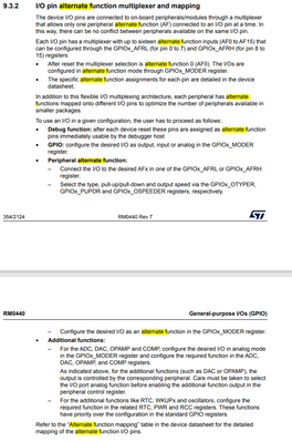

Hell @Tobe @######
AFx represent as said @###### the alternate function number x. you can configure a pin for a specific AFy by writing y to specific 4 bits of the:
  • GPIOx_AFRLx if the pin is pin n (n = 7 to 0)
  • GPIOx_AFRHx if the pin is pin n (n = 8 to 15).
For more details, take a look at the RM0440. pages 365/366
Best Regards.
