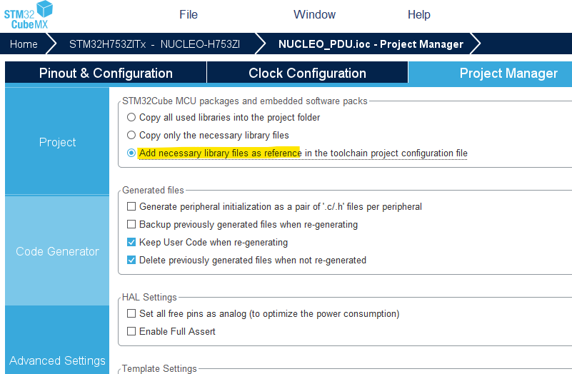

    > Can you point me to the github link for the libraries?
    With pleasure. https://github.com/STMicroelectronics/STM32Cube_MCU_Overall_Offer
    >  And I do not see the copy library files to references option under Project Properties option
    See below - this is for a standalone CubeMX, CubeIDE has something similar
