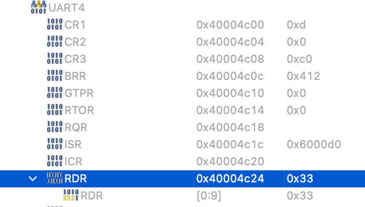

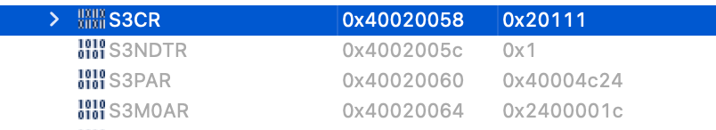

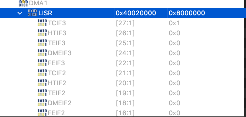

Hi everyone, just a question about this DMA not triggering for unknown reasons.
The only thing I can deduced is the switch from C to C++ and how variables behave within an object maybe.
All I know is the peripheral is working and the DMA is setting the right flag. I also tried the C version of my code and it worked. Double check the buffer is in the right memory region as well the RAM_D1.
0693W00000BcUZfQAN.png0693W00000BcUZpQAN.png0693W00000BcUZuQAN.pngFor some reason it doesnt wanna hit the void DMA1_Stream3_IRQHandler(). Yes I used the

The linker is looking for "DMA1_Stream3_IRQHandler", but if this function is with in a C++ file, the name it is mangled and so the linker doesn't find it. (It still compiles because there is a weakly defined default handler that it falls back to.)
Enclose the function in extern "C" brackets.
