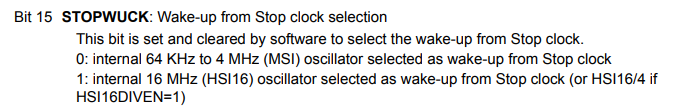

I'm using STM32L0 MCU, My system uses MSI as the main system clock, but my USART is to use HSI to be able to wake up from stop mode. My system will enter stop mode for power saving. I am confused about the settings, before enter stop mode, we have to set system clock after STOP mode using HAL API:
__HAL_RCC_WAKEUPSTOP_CLK_CONFIG(RCC_STOP_WAKEUPCLOCK_MSI); // Set system clock as MSI after stop
__HAL_RCC_WAKEUPSTOP_CLK_CONFIG(RCC_STOP_WAKEUPCLOCK_HSI); // Set system clock as HSI after stop so that USART able to wake up the MCU

The key point is the STOPWUCK bit. The RM states:
"MSI or HSI16 RC oscillator are selected as system clock for Stop mode exit by configuring the STOPWUCK bit in the RCC_CFGR register"
Hope that helps!
  • Before STOP: System clock using MSI. Nothing changes yet.
  • Enter STOP → system goes into low-power mode. Configured STOPWUCK bit to use HSI
  • Exit STOP → system will switch to HSI as the system clock.
After STOP exit, the system clock will change to HSI  instead of maintaining MSI as system clock source?
