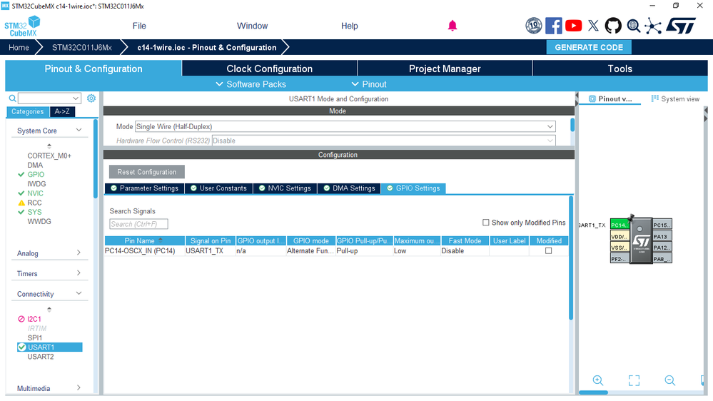

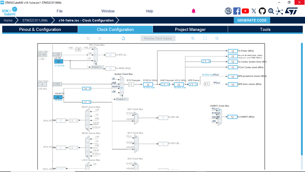

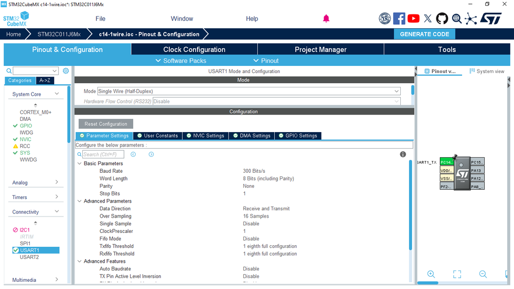

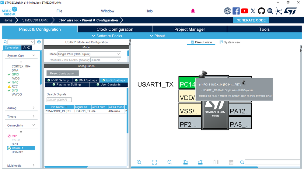

Need getting-started help with STM32C011J6M6 MCU and USART1 in single-wire Async mode (using STM32Cube toolchain and C language.)
The hardware configuration is just  the STM32C011J6M6 MCU (8-pin SOIC package) with one pin (pin 1) pulled up (4.7K to 3.3V). Intent is to use this in single-wire Async mode to communicate with outside world. All other MCU pins have similar pull-up resistors but are not otherwise connected. Power to the MCU for this test is furnished by the STLINK device. The test is using programmed I/O (no DMA,  no interrupts.) The test program solely is written to experiment with the USART1 in single-wire mode on this device; there  are no other aspects being tested or included.
Tools in use:
IDE 1.19.0
MX 6.15.0
PROG 2.10.0
Used STM32CubeMX to generate code template (targeting STM32CubeIDE), STM32CubeIDE to build the example (C-language) program, and STM32CubeProgrammer to push the resulting (elf) binary to the device using STLINK attached to the  SWCLK/SWDIO and power pins.
When running, expected result is that async bytes will appear on pin 1 (active low, open drain). Actual result is that pin 1 remains held high by it's pull-up resistor.
I previously checked hardware using another short  program (same tools) to set the pin as GPIO (open drain) and then toggled the pin high/low (with delay in loop) to verify electrical behavior.
Four screen grabs from STM32CubeMX are attached, as is the main.c program being used  for this test (a single ZIP file contains the five small files.)

Nice you figured that out. Your code is similiar to what's generated in my HAL_UART_MspInit (Src\stm32c0xx_hal_msp.c).
KnarfB
7 REPLIES 7
KnarfB
Your attachment hangs in the "(Virus scan in progress ...)" loop which seems to be a recent bug in the forum setup.
You may speed up things by using the "insert code samples" button in the menu bar and copying CubeMX screenshots.
Generally speaking: Should work out-of-the box without further setup code. The relevant Ref.Man. chapter:
26.5.15 USART single-wire half-duplex communication
Single-wire half-duplex mode is selected by setting the HDSEL bit in the USART_CR3
register. In this mode, the following bits must be kept cleared:
• LINEN and CLKEN bits in the USART_CR2 register,
• SCEN and IREN bits in the USART_CR3 register.
The USART can be configured to follow a single-wire half-duplex protocol where the TX and
RX lines are internally connected. The selection between half- and Full-duplex communication is made with a control bit HDSEL in USART_CR3.
As soon as HDSEL is written to ‘1’:
• The TX and RX lines are internally connected.
• The RX pin is no longer used.
• The TX pin is always released when no data is transmitted. Thus, it acts as a standard
I/O in idle or in reception. It means that the I/O must be configured so that TX is
configured as alternate function open-drain with an external pull-up.
hth

Created a fresh clone of your project, but have only a STM32C0116-DK for testing. PC14 and PB7 are not bonded together in that larger package. I can see the UART output clearly on PC14.

Thank you again KnarfB - your workbench support of my problem illuminated the direction to proceed and saved much spinning-of-wheels!
Worked out the issue -- turns out the GPIO initialization routine generated by STM32CubeMX (at least the version I'm using) only turns on the required clock for the peripheral. I added instructions (seen below in the alternate GPIO_Init function) to support USART in 1-wire mode based on the hardware that is being used (external pull-up resistor on SO8 MCU pin 1 selected as PC14.)
static void MX_GPIO_Init_C14(void)
  /* USER CODE BEGIN MX_GPIO_Init_1 */
  /* USER CODE END MX_GPIO_Init_1 */
  /* GPIO Ports Clock Enable */
  __HAL_RCC_GPIOC_CLK_ENABLE();
  // New code added for support of USART1_TX in 1-wire async mode
  HAL_GPIO_WritePin(GPIOC, GPIO_PIN_14, GPIO_PIN_SET);
  /*Configure GPIO pin : PC14 */
  GPIO_InitStruct.Pin = GPIO_PIN_14;
  GPIO_InitStruct.Mode = GPIO_MODE_OUTPUT_OD;
  HAL_GPIO_Init(GPIOC, &GPIO_InitStruct);
  HAL_SYSCFG_SetPinBinding(HAL_BIND_SO8_PIN1_PC14);
