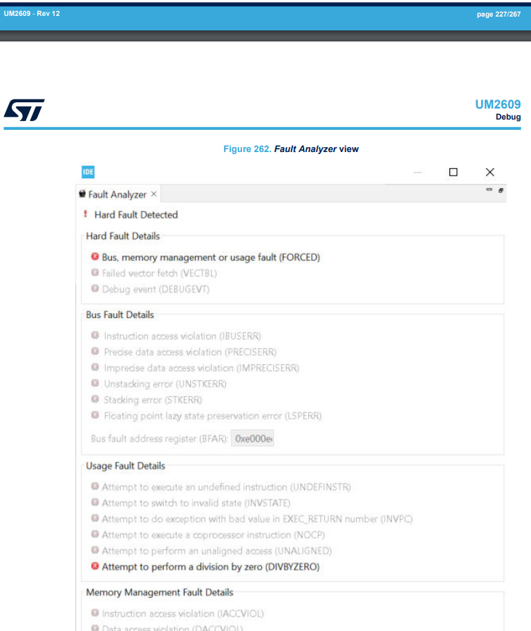

Andrew Neil
@VThan.2 wrote:
there is a hard-fault whenever I call the above functions.
So what have you done to debug the Hard Fault?
https://www.st.com/resource/en/user_manual/um2609-stm32cubeide-user-guide-stmicroelectronics.pdf

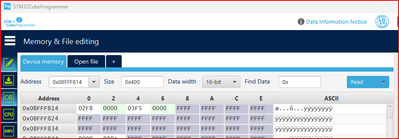

jllomibao
I am getting the same issue. It looks like 0x08FFF814 is not a valid address.
benjacam
I am also seeing this exact problem with STM32H573.
I see a hard fault just when reading TS_CAL1 with this code:
volatile uint16_t cal = *(volatile uint16_t*)0x08FFF814UL;
I've debugged the hardfault (well, chatgtp did the decoding..)
HFSR=0x40000000
CFSR=0x8200
BFAR=0x8fff814
1. HFSR = 0x40000000
  • Bit 30 (FORCED) = 1 → This means a configurable fault (like bus/memory/usage fault) escalated to HardFault.
  • Other bits are 0 → not a vector table read fault.
So: the real cause is in CFSR, not in HFSR.
2. CFSR = 0x8200
The CFSR is 32 bits, split into three sub-registers:
  • [31:16] UsageFault Status (UFSR)
  • [15:8] BusFault Status (BFSR)
  • [7:0] MemManage Fault Status (MMFSR)
Let’s decode 0x8200:
  • Binary: 1000 0010 0000 0000
  • Bits [15:8] = 0x82 → BusFault Status = 1000 0010
So BFSR bits:
  • Bit 7 (BFARVALID) = 1 → BFAR holds the faulting address.
  • Bit 1 (PRECISERR) = 1 → Precise data bus error.
  • Others = 0.
Thus: a precise bus fault occurred while accessing BFAR address.
No MemManage or UsageFault bits are set.
3. BFAR = 0x08FFF814
That’s exactly the TEMPSENSOR_CAL1_ADDR you pasted earlier.
So: the fault was triggered when the CPU tried to read the calibration constant at 0x08FFF814.
However, if I connect to the device using stm32programmer, I can see those addresses are written:
Is there a requirement to enable a specific clock or power domain to read these registers?
... I also just worked out why...
In this example linked below, there is a function MPU_Config which makes the area of flash containing trims un-cacheable. Adding this function results in no faults accessing the trims.
https://github.com/STMicroelectronics/STM32CubeH5/blob/f6cd6bcde45b717a229f73ded6258776e9a07a3e/Projects/NUCLEO-H533RE/Examples/ADC/ADC_MultiChannelSingleConversion/Src/main.c
