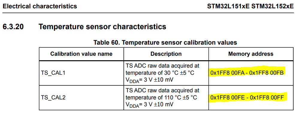

__LL_ADC_CALC_TEMPERATURE hardfaults / TS_CAL1 & TS_CAL2 read as zero
In trying to troubleshoot ADC DMA issues I have built the example code from:
STM32Cube\Repository\STM32Cube_FW_L1_V1.10.3\Projects\NUCLEO-L152RE\Examples_LL\ADC\ADC_MultiChannelSingleConversion
However, when it converts the results it hardfaults due to a divide-by-zero in __LL_ADC_CALC_TEMPERATURE() macro:
/* Computation of ADC conversions raw data to physical values */
 /* using LL ADC driver helper macro. */
 uhADCxConvertedData_VoltageGPIO_mVolt = __LL_ADC_CALC_DATA_TO_VOLTAGE(VDDA_APPLI, aADCxConvertedData[0], LL_ADC_RESOLUTION_12B);
 uhADCxConvertedData_VrefInt_mVolt = __LL_ADC_CALC_DATA_TO_VOLTAGE(VDDA_APPLI, aADCxConvertedData[1], LL_ADC_RESOLUTION_12B);
 hADCxConvertedData_Temperature_DegreeCelsius = __LL_ADC_CALC_TEMPERATURE(VDDA_APPLI, aADCxConvertedData[2], LL_ADC_RESOLUTION_12B); // This crashes
On closer inspection, *TEMPSENSOR_CAL1_ADDR and *TEMPSENSOR_CAL2_ADDR read back as zero, which is bourne out if I use the debugger to view memory at those locations.
For reference, the two defines are in stm32l1xx_ll_adc.h as follows:
/* Temperature sensor */
#if defined (TEMPSENSOR_CAL1_ADDR_CMSIS)
#define TEMPSENSOR_CAL1_ADDR ((uint16_t*) TEMPSENSOR_CAL1_ADDR_CMSIS) /* Internal temperature sensor, address of parameter TS_CAL1: On STM32L1, temperature sensor ADC raw data acquired at temperature 30 DegC (tolerance: +-5 DegC), Vref+ = 3.0 V (tolerance: +-10 mV). */
#define TEMPSENSOR_CAL2_ADDR ((uint16_t*) TEMPSENSOR_CAL2_ADDR_CMSIS) /* Internal temperature sensor, address of parameter TS_CAL2: On STM32L1, temperature sensor ADC raw data acquired at temperature 110 DegC (tolerance: +-5 DegC), Vref+ = 3.0 V (tolerance: +-10 mV). */
#endif /* TEMPSENSOR_CAL1_ADDR_CMSIS */
Which resolve to:
#define VREFINT_CAL_ADDR_CMSIS 0x1FF80078 /*!<Internal voltage reference, address of parameter VREFINT_CAL: VrefInt ADC raw data acquired at temperature 30 DegC (tolerance: +-5 DegC), Vref+ = 3.0 V (tolerance: +-10 mV). */
#define TEMPSENSOR_CAL1_ADDR_CMSIS 0x1FF8007A /*!<Internal temperature sensor, address of parameter TS_CAL1: On STM32L1, temperature sensor ADC raw data acquired at temperature 30 DegC (tolerance: +-5 DegC), Vref+ = 3.0 V (tolerance: +-10 mV). */
#define TEMPSENSOR_CAL2_ADDR_CMSIS 0x1FF8007E /*!<Internal temperature sensor, address of parameter TS_CAL2: On STM32L1, temperature sensor ADC raw data acquired at temperature 110 DegC (tolerance: +-5 DegC), Vref+ = 3.3 V (tolerance: +-10 mV). */
In stm32l152xba.h
The micro in use is an STM32L152RET6

Looks like the addresses it uses are not consistent with the user manual. Use STM32CubeProgrammer to verify the CAL factors are nonzero in memory in the datasheet locations.
Apr 7, 2022 7:14 PM UTC
> In stm32l152xba.h
That's not the correct include file for that chip.
The addresses in the current CMSIS include file stm32l152xe.h match those of the datasheet.
https://github.com/STMicroelectronics/STM32CubeL1/blob/master/Drivers/CMSIS/Device/ST/STM32L1xx/Include/stm32l152xe.h#L851

Thanks TDK - So this looks like a bug in the STM32Cube then, since I picked the micro & set the project up through Cube IDE and those are the headers it pulled in >:(
TDKBest answer
Apr 8, 2022 2:05 PM UTC
I mean, maybe. No offense, but I think it's more likely you picked the wrong MCU here. If you provide your IOC file I could replicate.
