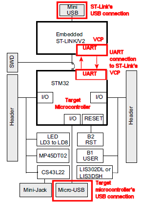

Posted on February 22, 2018 at 10:17
Perhaps this helps to distinguish the USB connection via the on-board ST-Link from the Target microcontroller's USB connection:

As has been pointed out a number of times, all Nucleo boards, and some later Discover boards provide a VCP connection as part of the ST-Link.
Why can you not justuse that?
There is no target software at all required to use the ST-Link's VCP connection - as far as the target STM32 is concerned, it is just a UART connection.

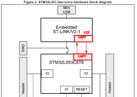

Posted on February 22, 2018 at 10:00
Like this:
