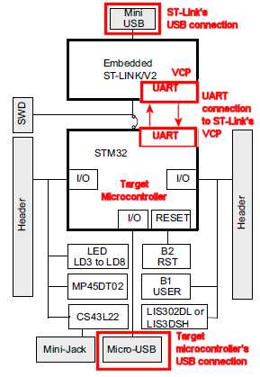

erenburg.evgeny.002 wrote:
 How ST-LINK involved here?
For goodness sake - have you not read any of the replies in this thread??
Look again at this picture:
There is no target software at all required to use the ST-Link's VCP connection - as far as the target STM32 is concerned, it is just a UART connection.
This is by far the simplest way to get a VCP connection from a Nucleo or Discovery board to a PC.
So, again, why can you not simply use the VCP provided by the ST-Link??
