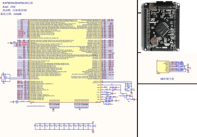

I tried testing it with a STM32F407 board, didn't work. Although I'm not sure if that's an official ST board, it's black, but it's got a ST logo on it.
But the code really only has SDIO configuration and the simplest operation. Why would it work on an official board and not on others. What has to be on the board for it to work?
Hi @KL_UOA
Sorry for not reaching out sooner, it would seem more interesting if you could provide us further details about your hardware setup? board? reference?
Best regards,
FBL
KL_UOA

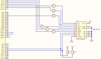

I've tested with a board we bought:
I doubt that this is an official ST board, even though the ST label is on it. The MCU on the board is STM32F407ZE. I've also tested with a custom-made board, with STM32F407VE. Here's the relevant part of the schematic:
I've got the same result from both boards. Is there anything from the board that could result in the issue I found?
