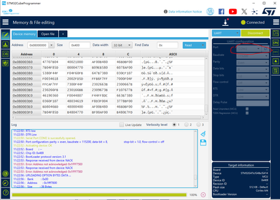

Nov 18, 2025 3:31 AM UTC
Hello @ST AME Support NF , @Laurids_PETERSEN ,
I have tried the tutorial of youtube video from the links of
https://github.com/STMicroelectronics/stm32wl-openbl-apps
with a stm32g474 eval board.
I can get connected with a uart1 (a usb-uart bridge) to the board from stm32 programmer as below

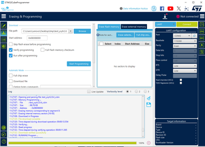

and i prepared an APP program and set the flash address to 0x8008000.
then I use stm32 programmer to download the APP bin file to 0x8008000.

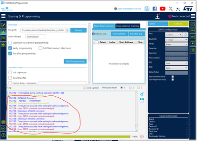

it can be downloaded but can not run exactly as below.
after I reset the board, the program start from 0x08000000, it can not start from 0x08008000.
so what is the problem?
