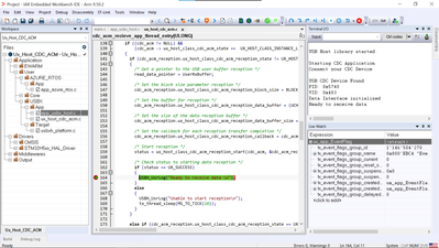

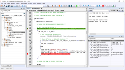

2024-10-01 12:11 PM
You are welcome @Mohan30
If you need example for device STM32CubeH5/Projects/NUCLEO-H503RB/Applications/USBX/Ux_Device_CDC_ACM at main · STMicroelectronics/STM32CubeH5 (github.com)
For host mode, I can share with you this example

2024-10-01 12:11 PM
