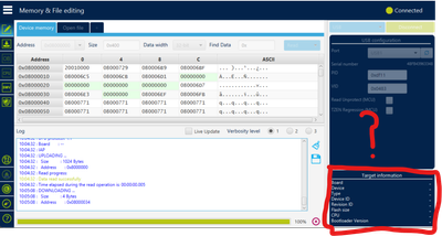

I used a F105RCT6 in a custom board, i want to use the DFU mod.
When I generate the project with cubemx I select USB DEVICE and DFU mid, i change the clock configuration corectly.
I generate the FW, and i flash him.
The DFU is running, i open cubeprogrammer, i can read the mcu but i can't flash him... or i flash but the fw is don't running, i'm don't understand...
For me, just the dowload is block.
Help me :)

Please check your reference manual for the flash chapter. Generally we do not support write-while-read function for flash, so you need to use IAP(bootloader) to program the internal flash

Can you use the built in bootloader USB DFU instead?
I can't :\
To give you the global context :
My objective is to use the usb port in Virtual COM mode, and to go in DFU mode with a specific command on the this virtual port.
My firmware is running good, i send a specific command and is going in DFU mode, i can read that's nice, but i can't erase and write ( i juste can read )
I hope I was quite precise
You can jump to the bootloader at will. Doing so will cause the board to be re-enumerated as a USB DFU device.

i don't resolve my problem :(
I think the problem is : i doesn't have CPU information loaded in dfu mod (see picture )
What's the problem? Looks like DFU is running fine.

Do you know how I can use the bootloader to update in USB mod ?
