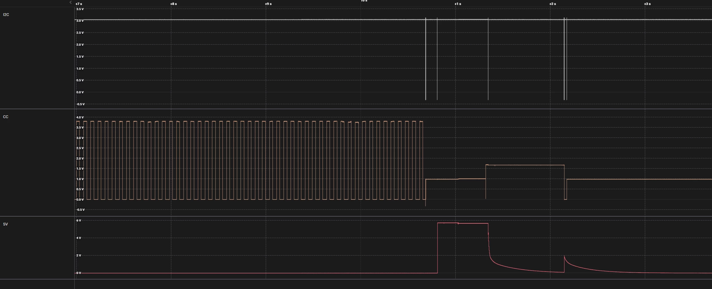

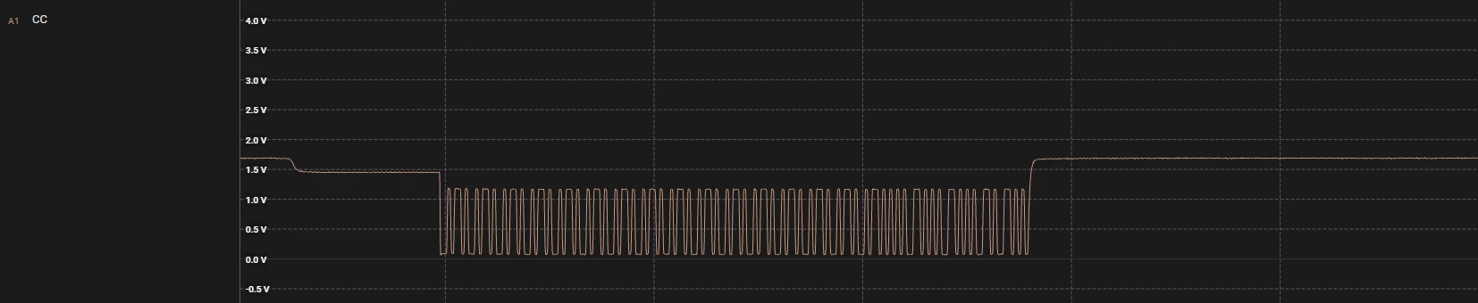

The issue is, that the device turns off the Power Path after 0,5Seconds and does not restart. Behaviour is the same, no matter if the sink device is attached to a running system or attached before the start.
I did some debugging, and it looks like a hardReset is triggered by the PE_CallHardResetCallback() which is triggered by the USBPD_PE_StateMachine(). I can not find both of the latter functions in the code so it is hard to debug.
I am honestly a little clueless, why this happens and what we can do about it?
Here are the waveforms for I2C Comms to the TCCP Chip, CC Line of USB C Connector and the 5V Rail after the switch of the TCCP:
Here are the waveforms for CC Communication:
