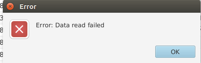

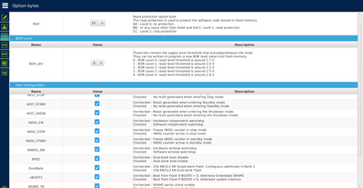

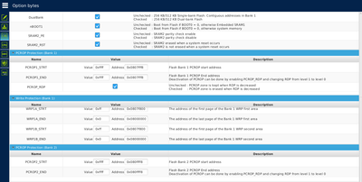

Now, when we performed OverTheAir upgrade of binary.bin where few hardware observeed extreme power fluctuations (more than 10-20times a second) and somehow MCU stops working. So we have to physically visit the location and connect ST-Link debugger which shows RDP got enabled with FF value. When set RDP to 0, it turned entire flash content to FF so we had to reflash the MCU with the help of ST-Link debugger
We got to learn from the detailed debugging that severe power fluctuation at the time of Flash write operation during init causing this. Once RDP is getting enabled our MCU stops executing which we confirm with attached LED over GPIOs. Since we found no way to revive this devices except recovering with the help of ST-Link debugger (setting RDP AA / Level 0 and reflash) which is not feasible solution so We want to understand what other possible operations can cause the similar behavior for that we can take preventive actions.
