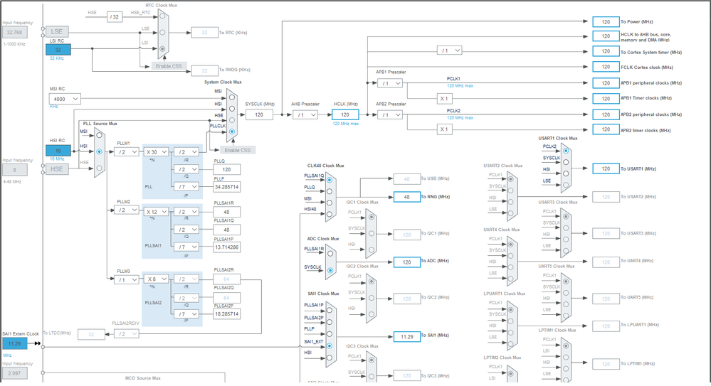

Upgraded my project to a new MCU, going from 80MHz to 120MHz SysClock. Since then my USART1 and 2 do not work well. My debugging until now suggests a baud rate problem. Where (which file) can I modify the prescaler/divisor if needed?

VNado.1
I have tried setting UART_PRESCALER_DIV64 according to what I calculated 120MHz/ (16 * 115200 Baud). That did change the characters, but still not the correct rate.
I have tried DIV32 and DIV128 without further success.
VNado.1
This is the clock config I have in CubeMX
