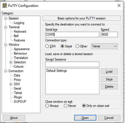

I use Putty and this is the settings:
I use "\t" so there is a tab space between measurement.
