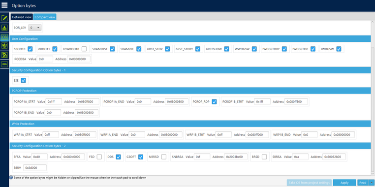

Check the option bytes values of SFSA and SBRV in CubeProgrammer. It could be linked to option bytes corruption.

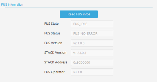

Could you please share your BLE fw version, and what CubeProg version used.

  • Option Bytes: I have attached a screenshot of the Option Bytes configuration from one of the boards where the BLE is not working. As far as I know, this configuration is identical across all boards (both working and non-working ones).
  • Versions: I've attached another image showing the current FUS and STACK versions. Additionally, the CubeProgrammer version I am using is v2.21.0.

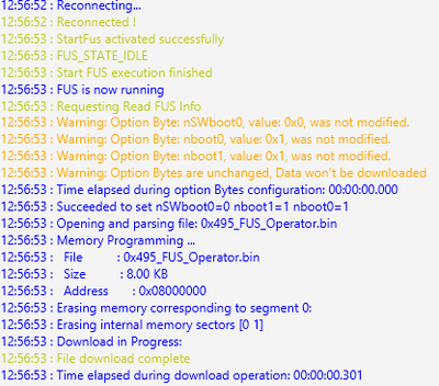

  • Logs: I have also included a screenshot showing the logs obtained from CubeProgrammer for you to review.
  • Mass Erase: I tried doing a full erase of our firmware and the FUS, and then reprogrammed them, but unfortunately, it was unsuccessful.
